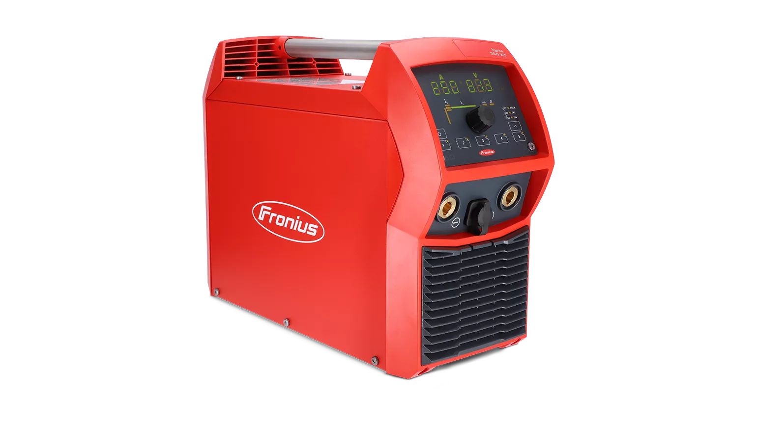

A true all-rounder: XT stands for Extended, because the Ignis 250 Extended version is designed for mains voltages from 200 to 600 V and can therefore be used worldwide. Depending on the power category and mains fuse, up to 250 A is possible in single-phase operation. Special features of the XT variant – Three-phase 200-600 V 10 %/+10 % – Single-phase use up to 250 A (depending on mains fuse protection) – Full generator compatibility – Higher energy efficiency
Technical Data
General Data
| Welding current min. | 10 A |
| Welding current max. | 250 A |
| Dimension / length | 488 mm |
| Dimension / width | 210 mm |
| Dimension / height | 369 mm |
| Weight | 17,3 kg |
