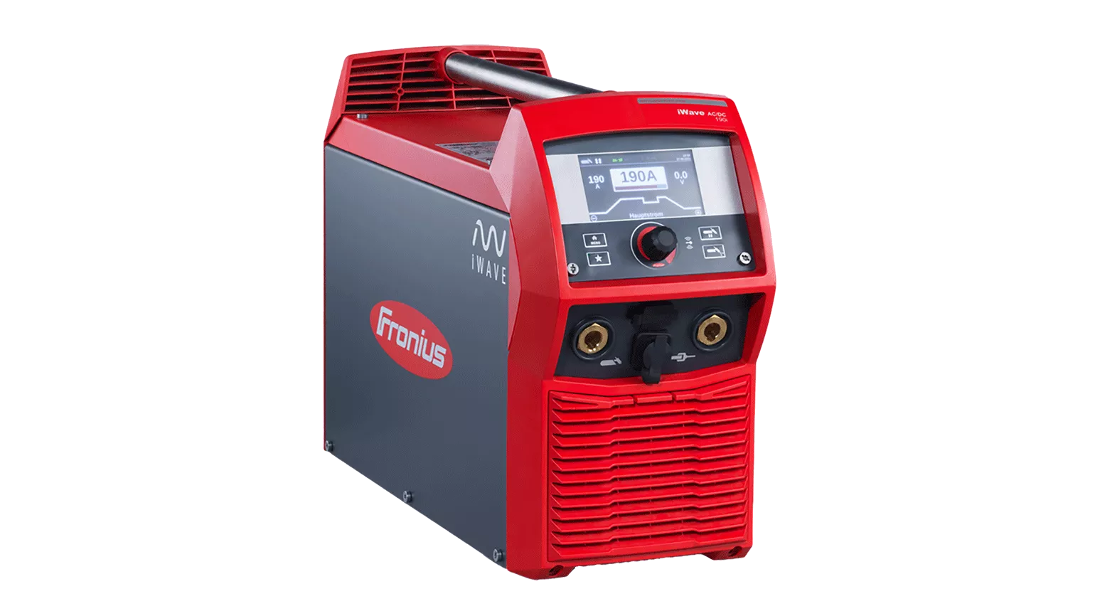

Technical Data
General Data
| Welding current min. | 3 A |
| Welding current max. | 190 A |
| Number of phases | 1 |
| Welding current / Duty cycle [10min/40°C] | 190 A / 35 % |
| Welding current / Duty cycle [10min/40°C] | 160 A / 60 % |
| Welding current / Duty cycle [10min/40°C] | 140 A / 100 % |
| Dimension / length | 558 mm |
| Dimension / width | 210 mm |
| Dimension / height | 369 mm |
| Weight | 17 kg |
