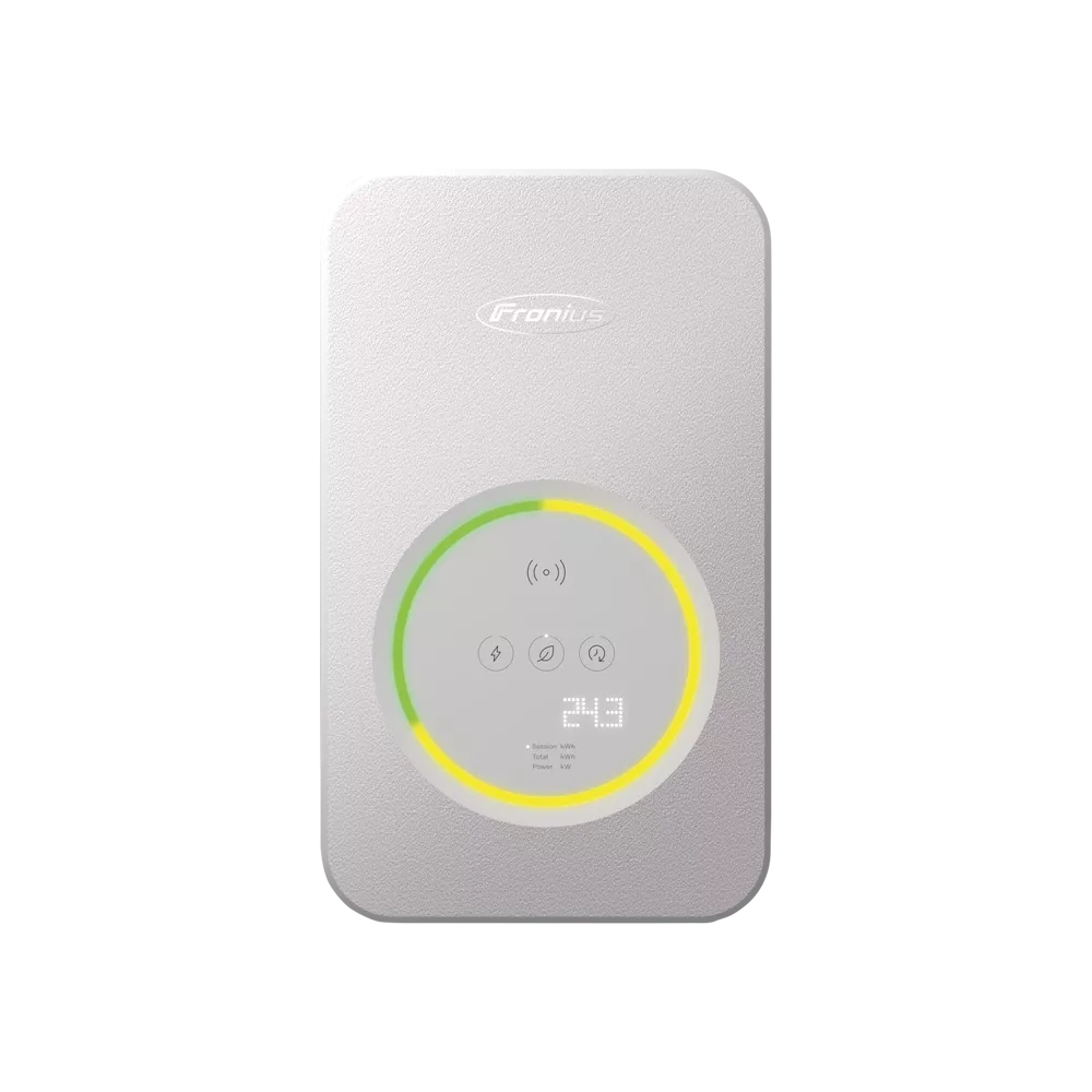

Technical data
Data  Wattpilot Flex Home Wattpilot Flex Pro**
Max. charging power  11/22 kW  11/22 kW
Dimensions (l x w x h)  325 x 195 x 105 mm  325 x 195 x 105 mm
Weight incl. type 2 charging cable  4.1/5.4 kg (11/22 kW)  4.1/5.4 kg (11/22 kW)
Charging cable  6 m cable with type 2 plug  6 m cable with type 2 plug
Cable entry  At the top (only permitted indoors), bottom, and rear  At the top (only permitted indoors), bottom, and rear
Network connection  LAN & WiFi  LAN & WiFi
MID meter  Not integrated  Integrated
Conformity with measurement and calibration law No  Yes
Color Telegray 4 Anthracite
Use* Indoors and outdoors Indoors and outdoors
*When installing outdoors, only the cable entry at the rear or the bottom may be used. The charging power can be limited by the Wattpilot in direct sunlight.
** Currently available in an 11 kW model. Information on the availability of the 22 kW model will follow.
