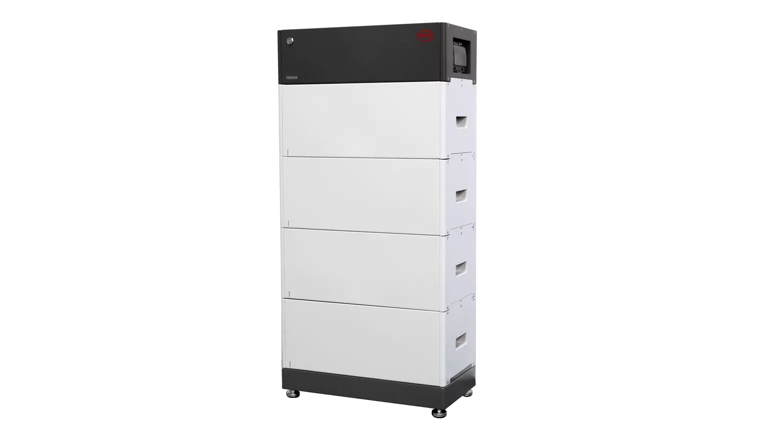

The BYD Battery-Box Premium line impresses with the following strengths:
/ Lithium iron phosphate battery storage unit, modularly expandable in 2.6 kWh (HVS) and 2.8 kWh (HVM) steps
/ Storage capacities from 5.1 to 12.8 kWh (HVS) and from 8.3 to 22.1 kWh (HVM)*
/ Parallel operation of up to 3 battery storage units possible**
/ Backup power capability (with PV Point and Full Backup)
/ High charging and discharging powers
/ Quick and easy floor installation
* Depending on the type of inverter, country-specific certification and availability
** Note: A combination of 3x HVM 22.1 is not possible. Parallel operation depends on the respective availability in the country and certification.
