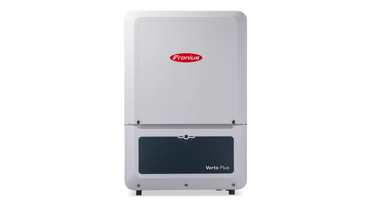

Verto Plus
Technical Data
Input Data
| Number of MPP trackers | 3 |
| Maximum PV input power | 13 kW |
Feed-in start voltage (Udc start) | 150 V |
Nominal input voltage (Udc,r) | 600 V |
| Min. MPP voltage (Umpp min) | 150 V |
| Max. MPP voltage (Umpp max) | 870 V |
Max. PV generator power (Pdc max) | 22,5 kWpeak |
Max. input current string (Idc max, String) | 28 A |
Output Data
AC nominal output (Pac,r) | 15 kW |
Max. output power (Pac max) | 15 kVA |
| Max. grid power demand | 15 kVA |
Battery Connection
| Min. DC input voltage Battery input | 150 V |
| Max. DC input voltage Battery input | 700 V |
General Data
| Mains Frequency | 50 Hz, 60 Hz |
| Dimension / width | 574 mm |
| Dimension / height | 865 mm |
| Dimension / depth | 279 mm |
| Weight | 43 kg |
| Weight incl. packaging | 50,7 kg |
| Degree of protection | IP66 |
| Protection class | 1 |
| Night-time consumption | 16W |
| Min. permissible ambient temperature | -40 °C |
| Max. permissible ambient temperature | 60 °C |
| Permitted humidity | 0 - 100% |
| Sound emissions | 50,3 dB(A) |
General Data
| Weight | 43 kg |
Technical Data
| Grid connection | (N)PE |
