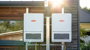

Person standing next to two Verto Plus inverters mounted on an exterior wall, holding documents

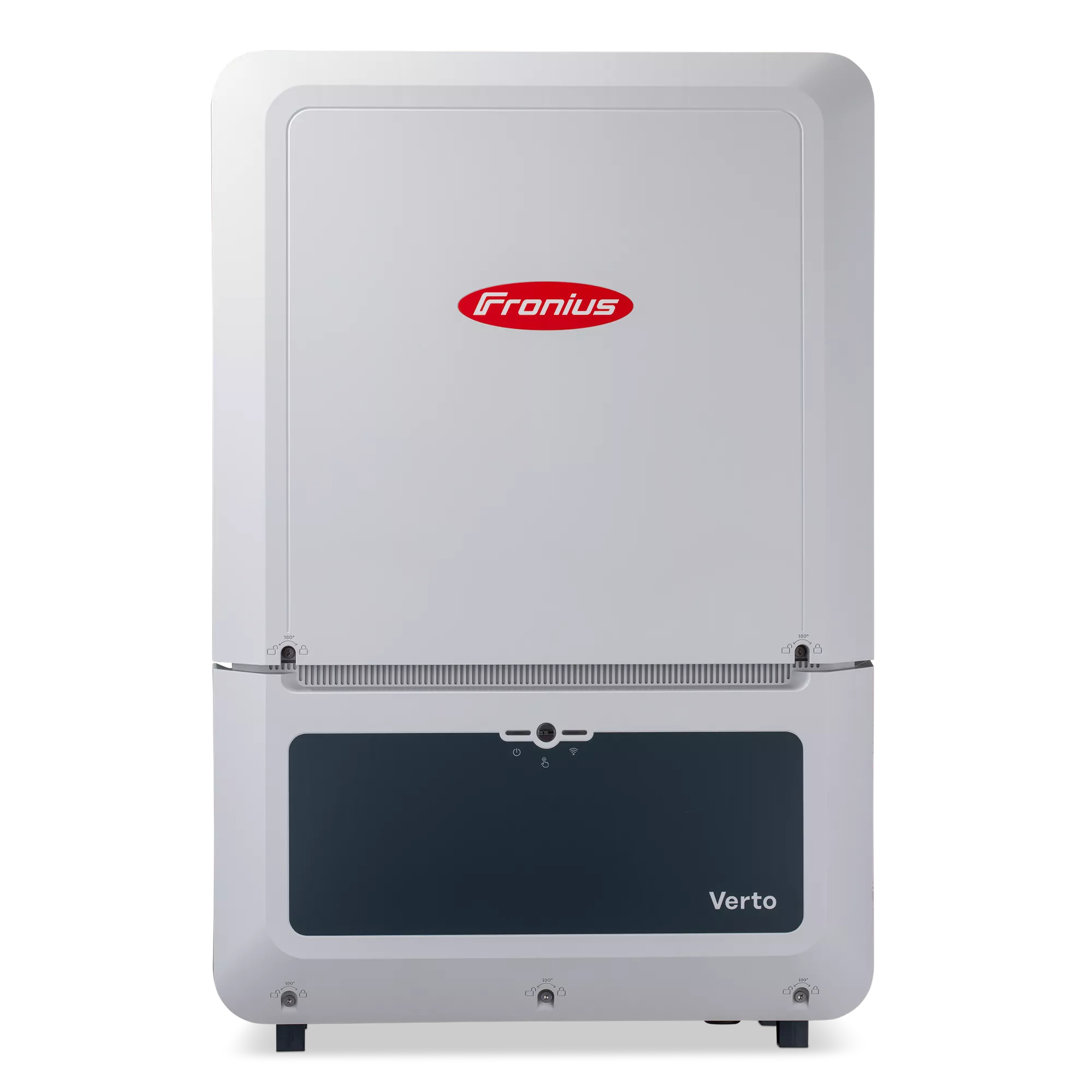

Fronius Verto 15-25
Verto 15.0 - 25.0
  • String inverter
  • 3 MPPTs
  • DC inputs: 4
  • DC SPD type 1+2
  • DC SPD type 2
  • AFCI

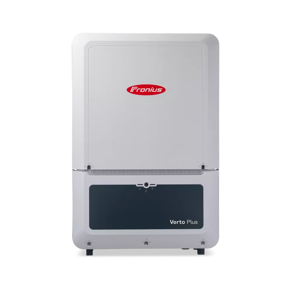

Fronius Verto Plus 25-33
Verto Plus 15.0 - 33.3
  • Hybrid inverter
  • 3 MPPTs
  • DC inputs: 6
  • DC SPD type 1+2
  • AC SPD type 2
  • AFCI
  • Powerful battery input
  • Full Backup with Backup Power Boost
  • Enhanced Power Harvest

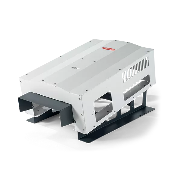

    Verto flat roof mounting set
    The Verto flat roof mounting set provides additional protection against direct sunlight and can be mounted on both flat roofs and walls.
