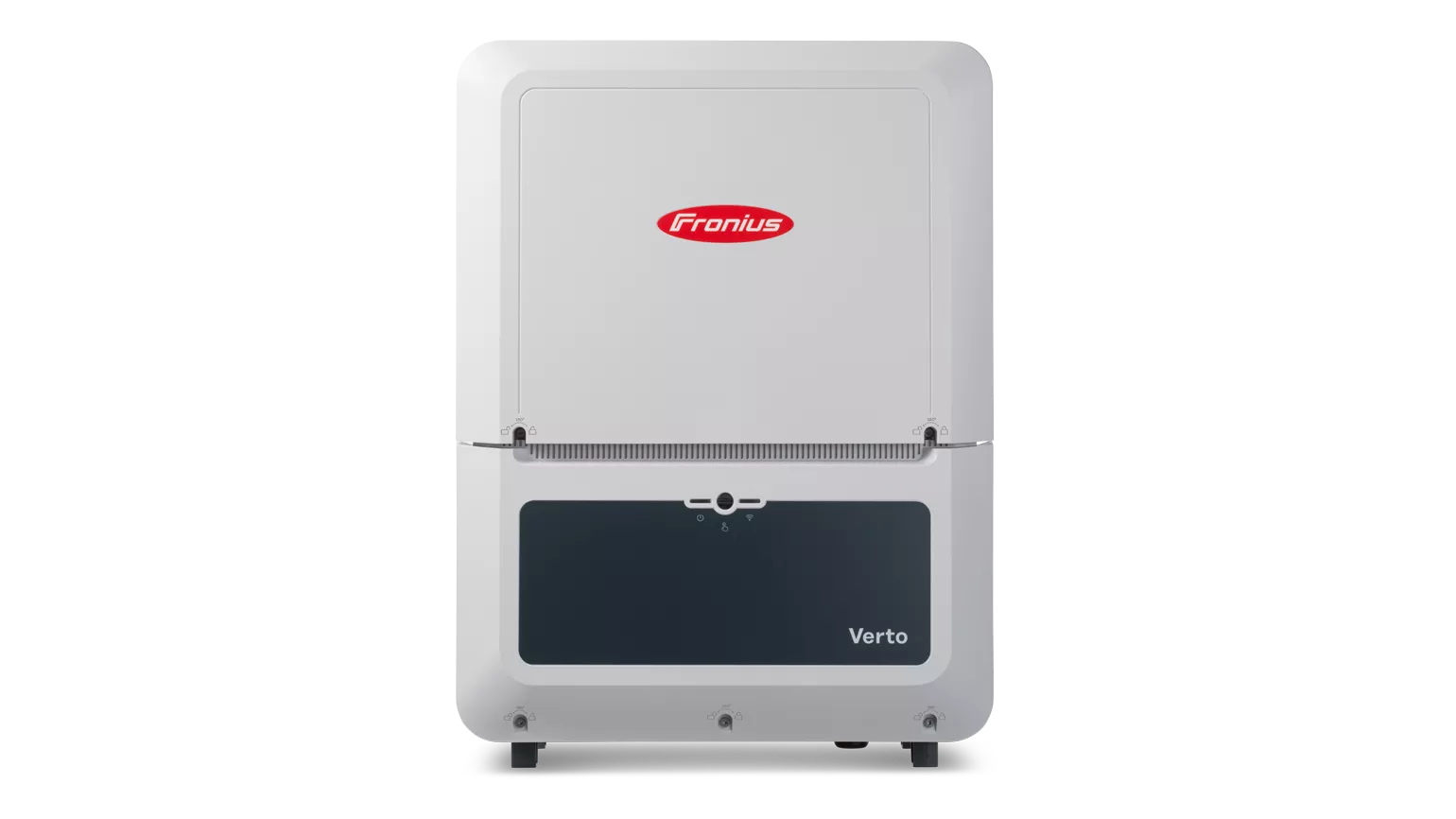

Verto
Technical Data
Input Data
| Number of MPP trackers | 3 |
Feed-in start voltage (Udc start) | 150 V |
Nominal input voltage (Udc,r) | 620 V |
| Min. MPP voltage (Umpp min) | 150 V |
| Max. MPP voltage (Umpp max) | 870 V |
Max. PV generator power (Pdc max) | 22,5 kWpeak |
Max. input current string (Idc max, String) | 28 A |
Output Data
AC nominal output (Pac,r) | 15 kW |
Max. output power (Pac max) | 15 kVA |
| Max. grid power demand | 15 kVA |
| Max. AC output current | 38,5 A |
Grid connection (Uac,r) | 380/220V 400/230V 440/254V 480/277V |
AC voltage range (Umin - Umax) | 176-528V |
General Data
| Dimension / length | 278,2 mm |
| Dimension / width | 539,6 mm |
| Dimension / height | 730,4 mm |
| Dimension / depth | 278,2 mm |
| Weight | 35,2 kg |
| Weight | 32,58 kg |
| Weight incl. packaging | 41,75 kg |
| Degree of protection | IP66 |
| Protection class | 1 |
Overvoltage category (DC / AC) 1) | AC-Overvoltage Category in accordance with IEC 62109-1 / EN 60664-1: 3 DC-Overvoltage Category in accordance with IEC 62109-1 / EN 60664-1: 2 |
| Night-time consumption | 12W |
| Min. permissible ambient temperature | -40 °C |
| Max. permissible ambient temperature | 60 °C |
| Permitted humidity | 0 - 100% |
| Sound emissions | 56,5 dB(A) |
Efficiency
| Max. efficiency (PV - grid) | 98,5 % |
| European efficiency (ηEU) | MPPmin: 97,27% MPPnom: 98,40% MPPmax: 97,96% |
η at 5% Pac,r 3) | MPPmin: 93,10% MPPnom: 94,57% MPPmax: 90,95% |
η at 10% Pac,r 3) | MPPmin: 95,61% MPPnom: 96,84% MPPmax: 94,98% |
η at 20% Pac,r 3) | MPPmin: 96,94% MPPnom: 98,00% MPPmax: 97,01% |
η at 30% Pac,r 3) | MPPmin: 97,30% MPPnom: 98,32% MPPmax: 97,70% |
η at 50% Pac,r 3) | MPPmin: 97,47% MPPnom: 98,50% MPPmax: 98,11% |
η at 75% Pac,r 3) | MPPmin: 97,35% MPPnom: 98,53% MPPmax: 98,24% |
η at 100% Pac,r 3) | MPPmin: 97,19% MPPnom: 98,46% MPPmax: 98,22% |
Technical Data
| Grid connection | (N)PE |
