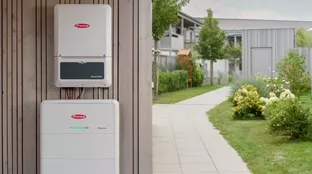

Compatible battery storage
for Fronius hybrid inverters
The perfect storage solution. Powered by Fronius.
Fronius hybrid inverters are compatible with a range of battery storage systems. For particularly efficient and seamless integration, we recommend the Fronius Reserva & Reserva Pro: It is designed to fit seamlessly into the Fronius ecosystem, delivering exceptional efficiency and performance.
Our inverters also support storage systems from other manufacturers (such as BYD or LG), giving you complete flexibility when selecting a battery, whether you choose a proven third-party option or the Fronius storage solution.
