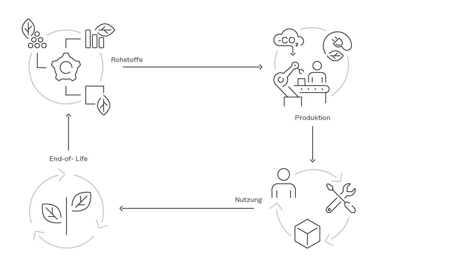

As a result, we now have a detailed picture of the analyzed welding applications with the TPS/i. The comprehensive cradle-to-grave approach applied in an LCA offers an in-depth look at our welding machine’s life cycle—starting with raw materials procurement, continuing through production, transport, and many years of use across shifts in an industrial setting, including wear parts, and concluding with recycling at the end of the machine’s service life.

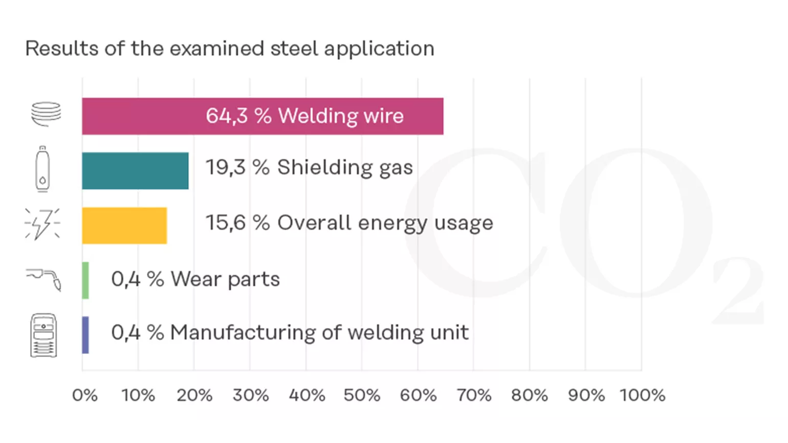

We wanted to be able to compare the results, so we translated the calculated carbon footprint over to one meter of weld. Every component and every welding application is individual and influenced by many factors, such as the base material, the seam geometry, and the welding parameters used. We chose this framework for the analysis so the results could be presented clearly and would be easy to understand.
Breakdown of the CO2 proportion, translated to a 1-m weld:
We also have solutions that are easy to implement, such as the OPT/i Gas controller, which reduces shielding gas use by an average of 40%. In the case of short welds, the savings potential is even higher.

After all, making efficient use of resources is the most effective way to leverage carbon savings. Just 0.5% or so of the entire CO2 equivalents in the life cycle of a Fronius TPS/i welding system can be attributed to its manufacture. A CO2 equivalent refers to the unit of measurement that is used to compare the climate impact of the various greenhouse gases with that of carbon dioxide in one value. In other words, the manufacture, repair, and disposal of a welding system doesn’t even contribute 1% of its CO2 equivalents, with the overwhelming share resulting from filler metals, shielding gas, and energy consumption. This demonstrates that these resources need to be used particularly efficiently—and that the biggest lever lies in conserving resources during use.
