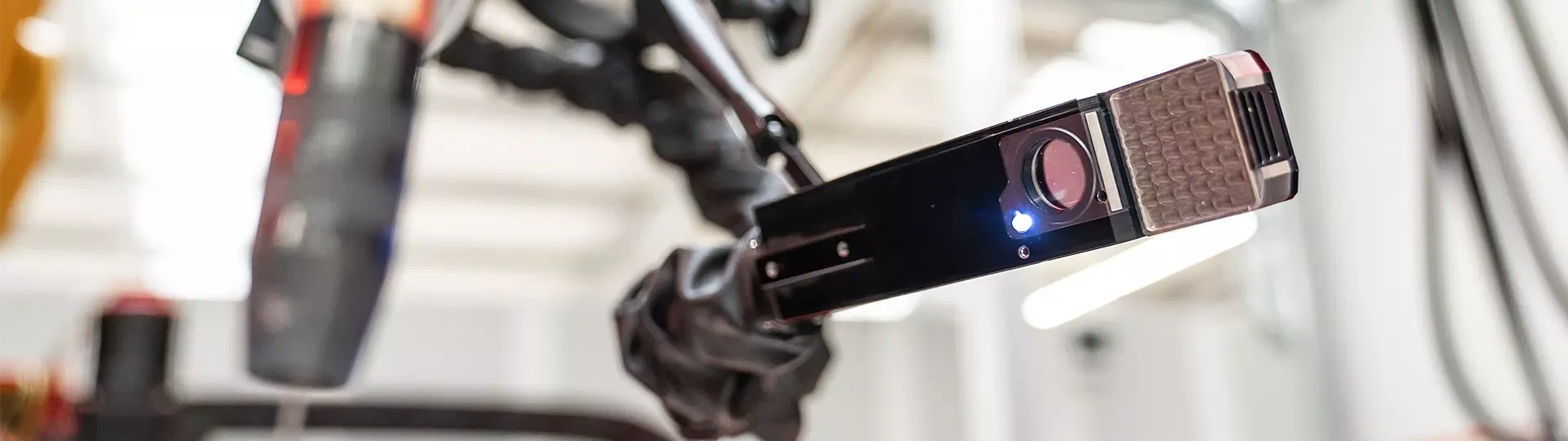

Optimal accessibility
Even in challenging environments—for example, where large components or systems are involved—you can easily monitor the welding process with ArcView. Thanks to its compact and robust design, the tool can even be used in pipes and under special climatic conditions.

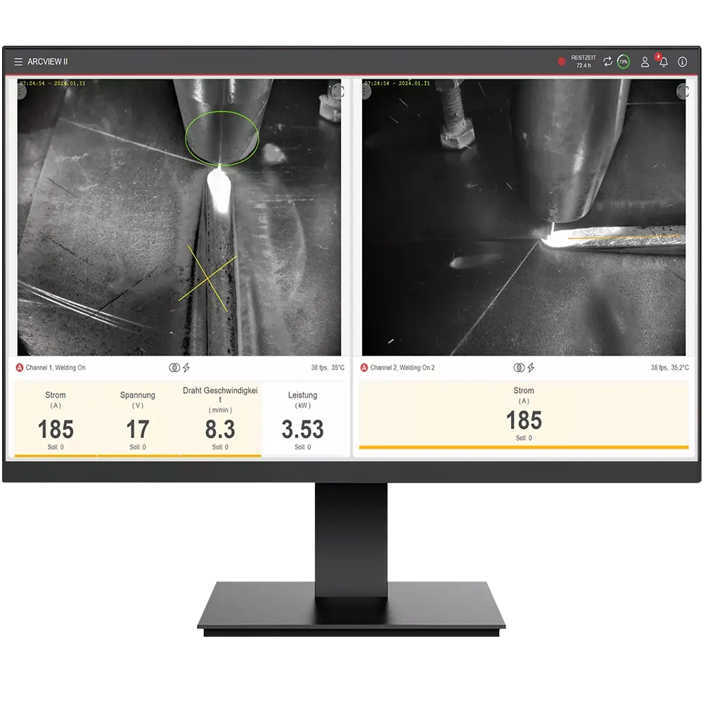

All welding data at a glance: ArcView2 is easy to operate via a user-friendly graphical PC user interface. Important welding parameters, such as current, voltage, and wire speed, are clearly displayed. You can integrate the cameras into partially and fully automated welding systems without a system operator having to be in the immediate vicinity of the welding process. This boosts flexibility and safety for your team.

With ArcView2, you can not only monitor your welding process in real time, but also record and archive valuable video data. Other functions of the camera system help you to fully exploit your welding potential and take your quality standards to the next level.
  • Triggered image recording (short circuit, pulse base current phase)
  • Automatic, process-synchronous profile switching via signal from the welding machine
  • Numerical display of actual values (U, I, vD, P)
  • Systems can be controlled and monitored from a central location
  • Support through client access
