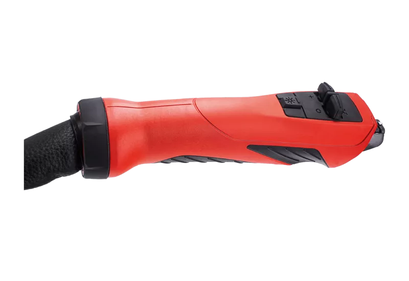

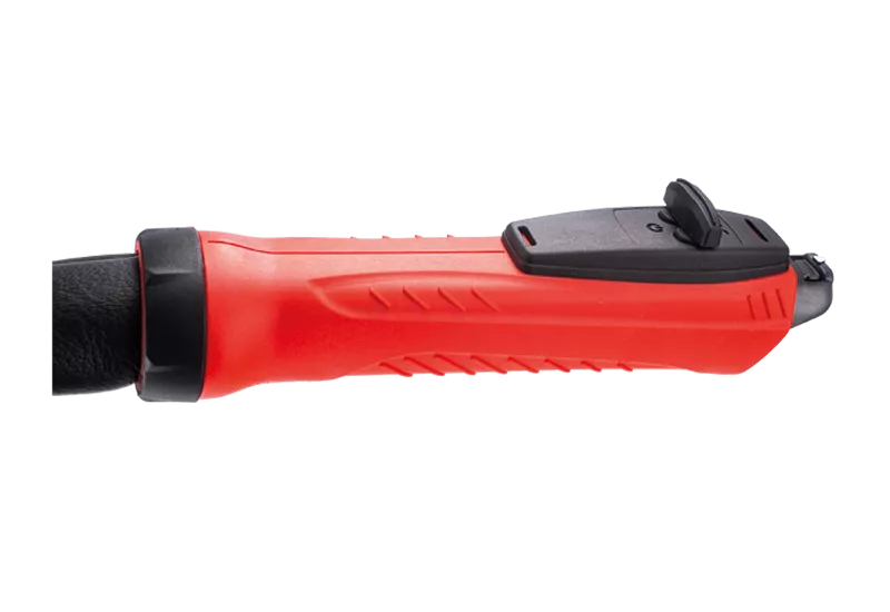

Protection against fatigue and a secure, non-slip grip are all guaranteed by the ergonomically designed handles of the Multilock hosepacks in the new TIG torch generation. The ball joint and extremely flexible hosepack also make handling easier, especially when the welding locations are difficult to access. In addition to different power categories, there are two handle versions that can be equipped with different operating elements and torch body versions.

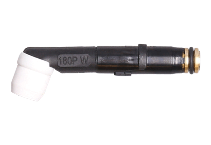

TTB - Multilock torch bodies

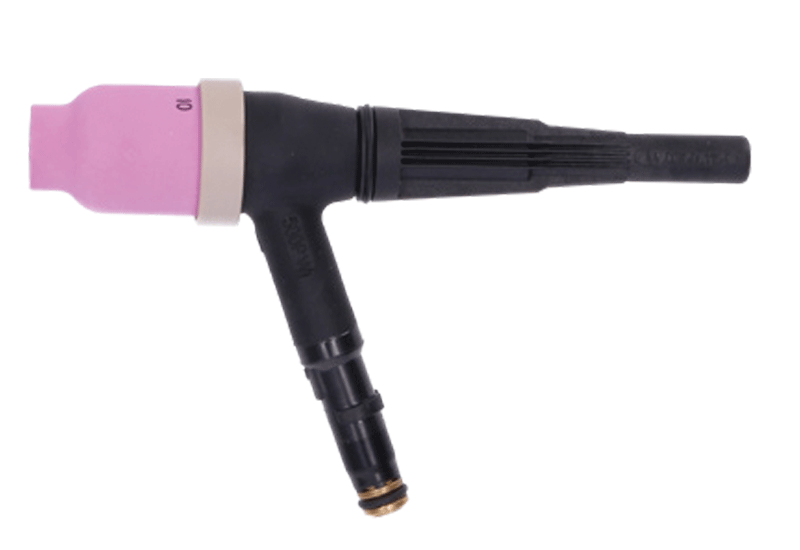

water-cooled torch body
TTB 180P W ML
Welding current (ArCO2)
  • TIG DC 60/100% D.C.: 180/140 A
  • TIG AC 35/100% D.C.: 140/110 A
  • Electrode diameter: 1.0–3.2 mm
TTB 300 W ML*
  • TIG DC 60/100% D.C.: 300/230 A
  • TIG AC 60/100% D.C.: 250/190 A

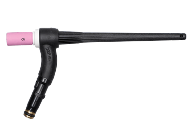

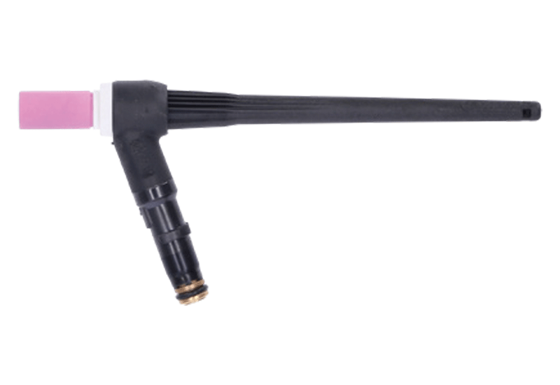

TTB 300 W ML flex*
TTB 400 W ML*
  • TIG DC 60/100% D.C.: 400/300 A
  • TIG AC 60/100% D.C.: 320/250 A
  • Electrode diameter: 1.0–4.8 mm
TTB 400 W ML flex*
  • Electrode diameter: 1.0–4.0 mm
TTB 500 W ML*
  • TIG DC 60/100% D.C.: 500/400 A
  • TIG AC 60/100% D.C.: 400/300 A
  • Electrode diameter: 1.0–6.4 mm

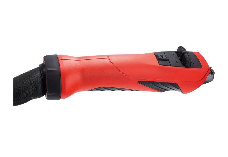

    THP - Multilock hosepacks
    TIG welding torch water-cooled
    THP 300i W ML
     Control variants
    • Hosepack length: 4/8 m
    • Up/Down
    • JobMaster
    • Potentiometer
    THP 400i W ML
     Control variants
    • TIG AC 60/100% D.C.: 350/270 A
    • Up/Down
    • JobMaster
    • Potentiometer
    THP 500i W ML
     Control variants
    • Up/Down
    • JobMaster
    • Potentiometer
    THP 300i W SH ML
     Control variants
    • Up/Down
    • Standard
    • Potentiometer
    • Long trigger
    • No trigger

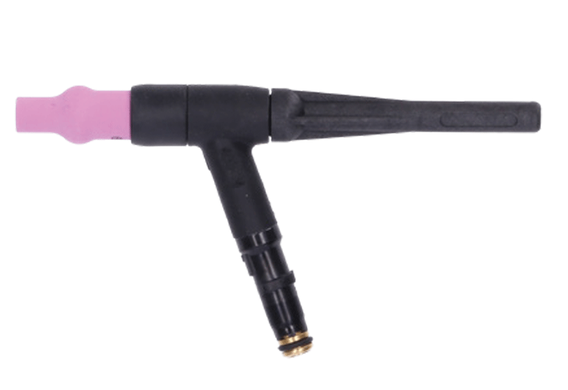

      TTW - Welding torches
      TTW 225 P
      TTW 225 P flex
      • TIG DC 35/60% D.C.: 225/155 A
      • TIG AC 35/60% D.C.: 380/265 A
       Control variants
      • No push button
      • Option: RC Bar Up/Down
      TTW 380 P
      TTW 380 P flex
      • TIG DC 35/60% D.C.: 135/95 A
      • TIG AC 35/60% D.C.: 180/125 A
       Control variants
      • No push button
