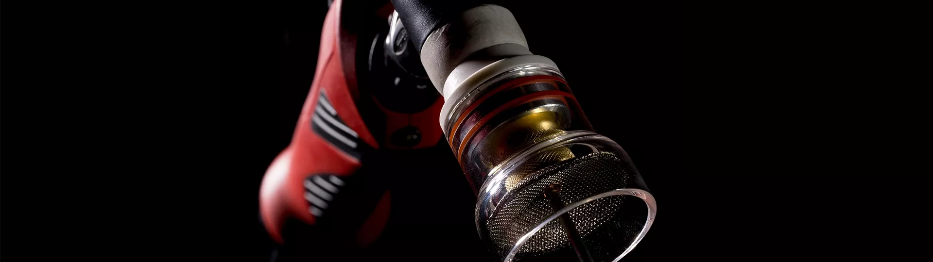

Gas lenses: for optimum shielding gas coverage
The lenses ensure a laminar gas flow and provide consistently high-quality shielding gas coverage. They keep gas losses to a minimum, reduce turbulence, and as such contribute to uniform welds. Their long service life makes them a cost effective choice for pros.
Gas screen: protective function for uniform gas flow
When used in combination with the gas lens, the gas screen delivers a particularly uniform, laminar gas flow. It effectively protects the gas lens from wear (for example from welding fume) and therefore contributes to a longer component service life.

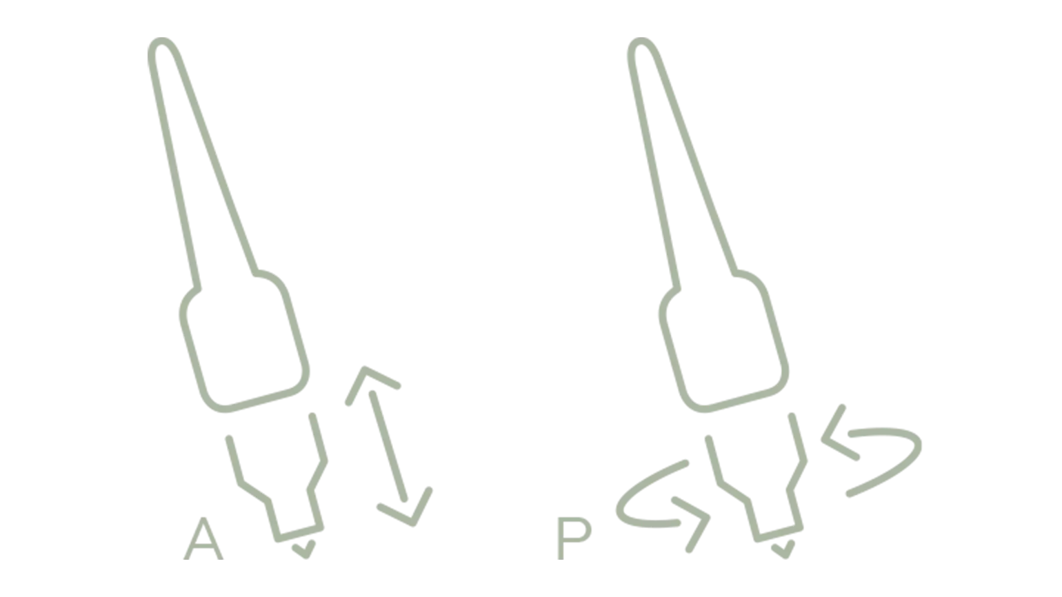

A and P system
The tried, tested, and familiar A- and P-systems
A-system: with push-on gas nozzle for quick and easy replacement
P-system: with screw-type gas nozzle for maximum stability and a long service life
Both systems have proven their worth in practice and offer custom solutions for different requirements. Whether you need flexibility or stability—the choice is yours! Both solutions deliver unbeatable quality and facilitate professional welding with optimum results.
