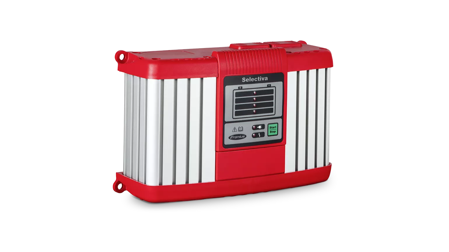

Battery chargers for 12 V / 24 V batteries
One battery charger for every battery
The battery chargers from the Selectiva product family offer flexible charging of batteries with different voltages and capacities. Among the benefits for you are the simple and standardised operation and amount of space needed as well as low operating costs.
Technical Data
General Data

Active Inverter
- Compact dimensions and low weight for flexible application options - Optimised charging process for maximum energy efficiency and lower energy costs - Conservation charging minimises the risk of self discharge, even during longer periods of non-use - High performance: optimal use of battery capacity
