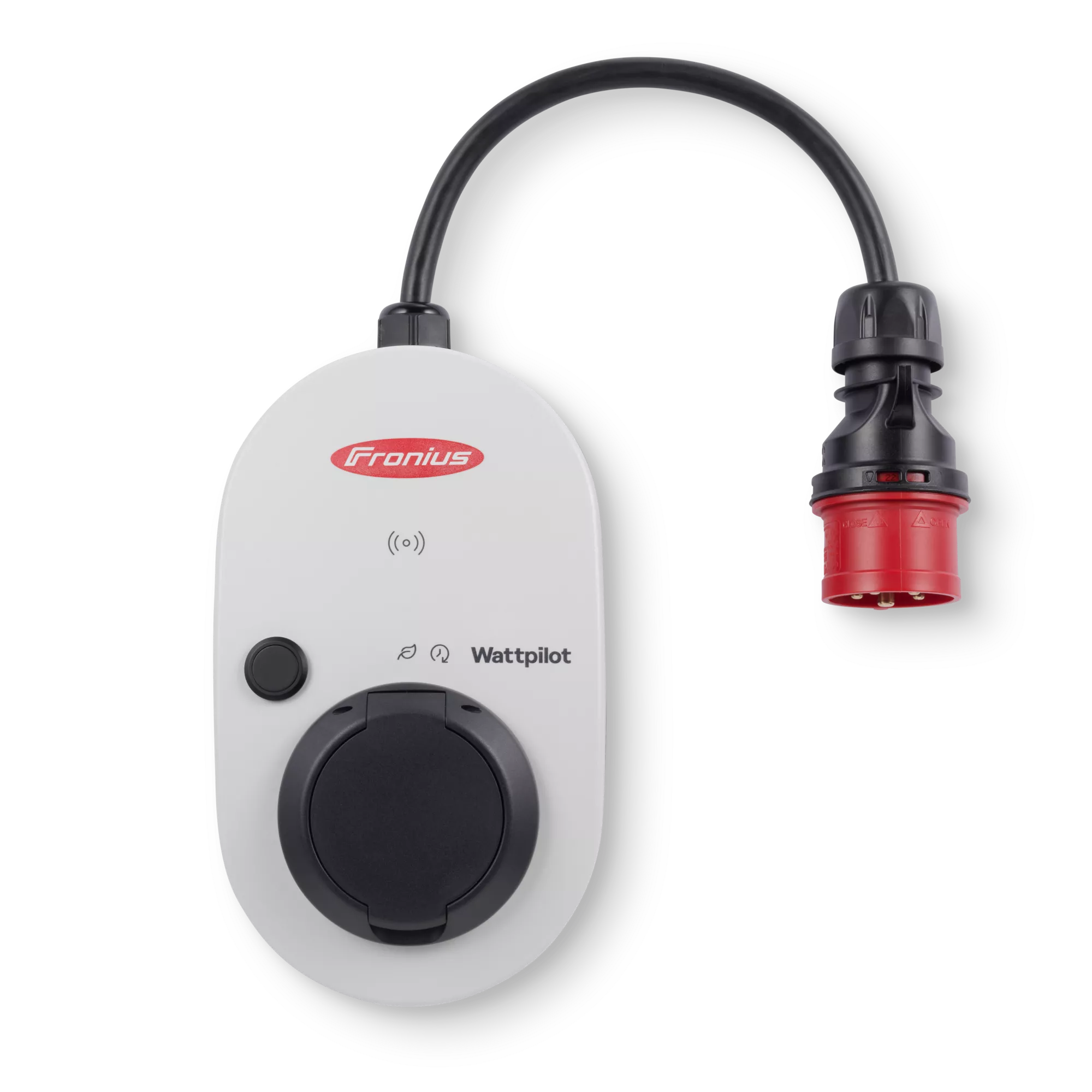

- Wattpilot Go for on the go (mobile solution)

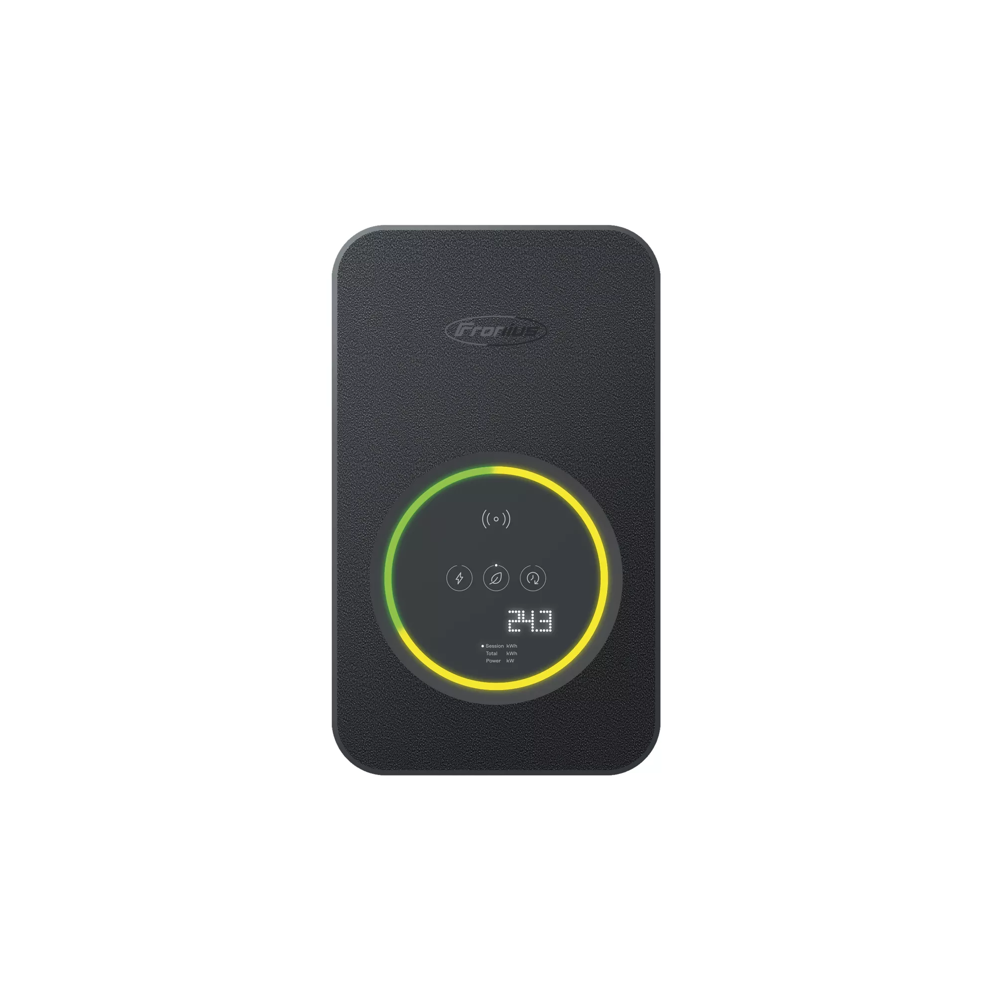

- Fixed 6 m type 2 charging cable
- Intuitive operation and high-quality product design (winner of the German Design Award 2025)
- Separate button for each mode
- Dot-matrix power and energy display
- Continuous LED ring - Integrated MID meter / conformity with measurement and calibration law (Wattpilot Flex Pro only)
- Connection area in the wall mounting plate with built-in spirit level
- Additional LAN interface
- Cable entry from above, below and behind
- Plug holder and two RFID tags included
- ISO 15118 (Plug & Charge) hardware-ready
- Very space‑saving thanks to its 10 cm depth and innovative plug holder

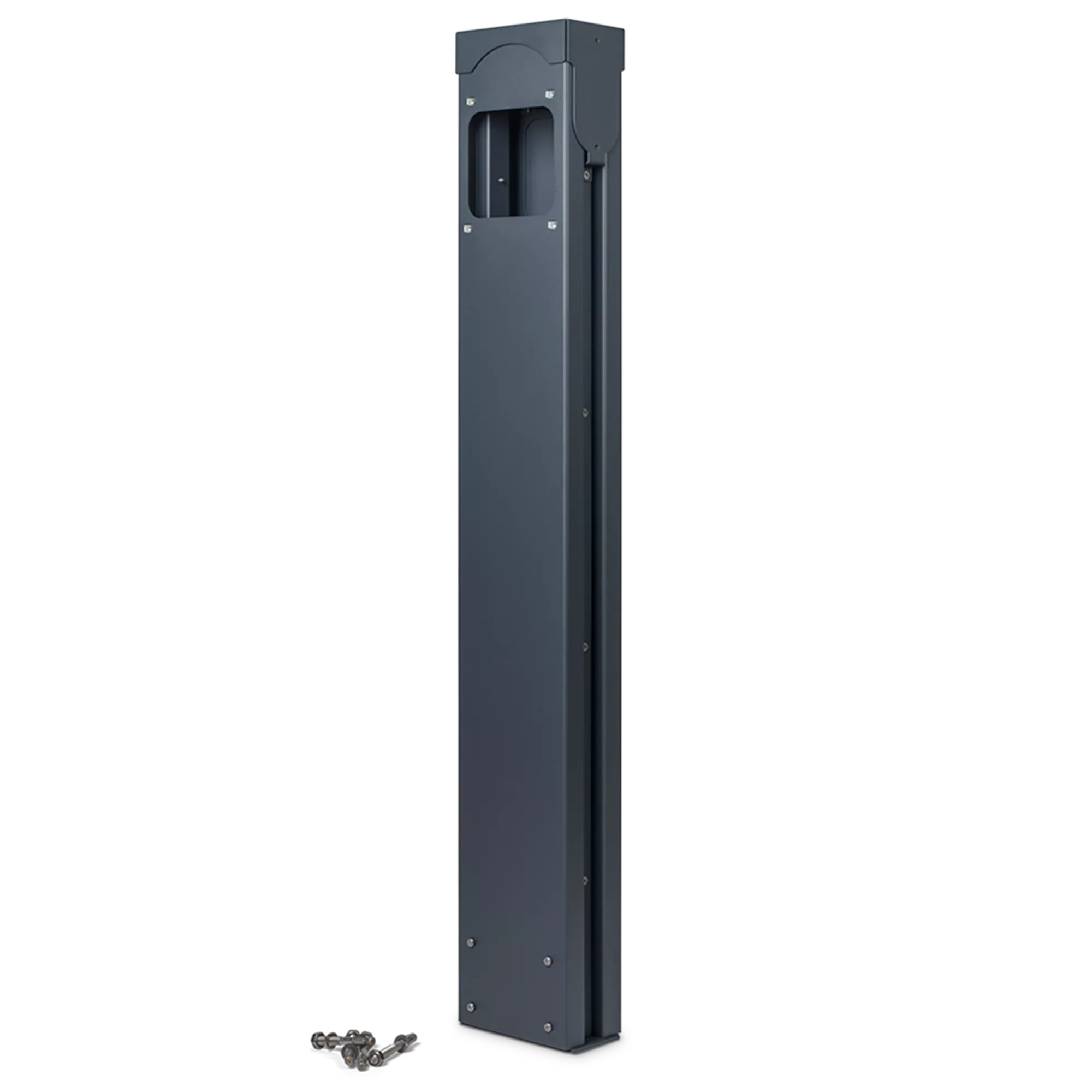

Optional accessories include a pedestal, a pre‑installation kit (wall mounting plate including cover plate), and a set of 10 ID chips.
Wattpilot Home / Go:
- Mounting bracket, incl. screws and rawlplugs
- Wattpilot
- Anti-theft device
- Reset card
- 1 ID chip
- Quick Guide

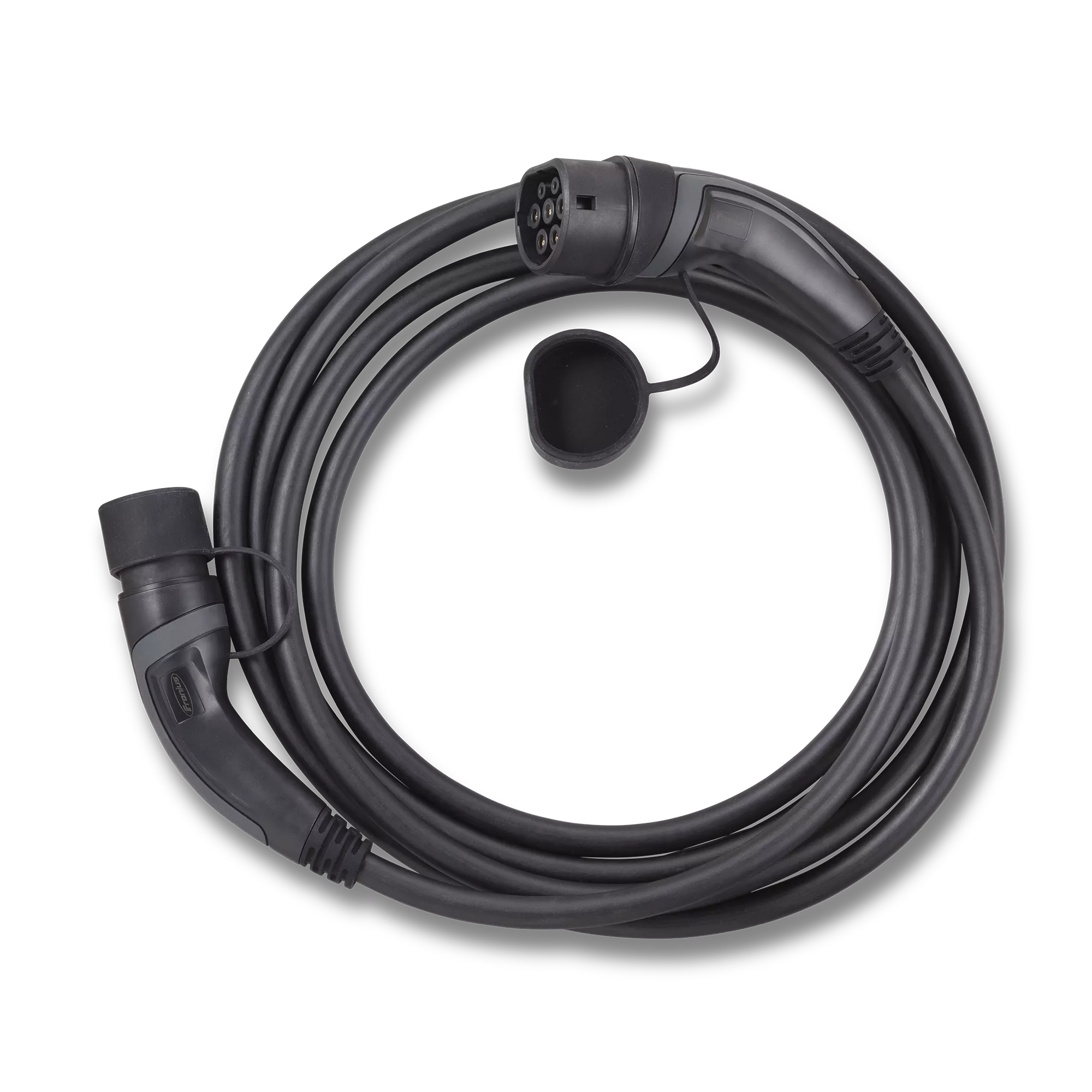

Optional accessories include a Type‑2 cable (2.5 / 5 / 7.5 m), a set of 10 ID chips, an additional mounting plate, a Type‑2 plug holder, and various adapter sets.
