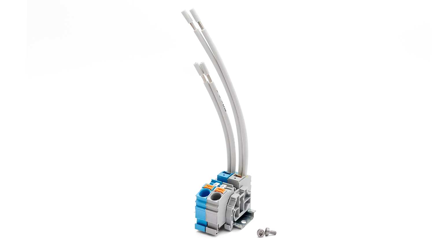

GEN24 Accessories
Technical Data
General Data
| Dimension / length | 90 mm |
| Dimension / width | 55 mm |
| Dimension / height | 90 mm |
| Dimension / depth | 90 mm |
| Weight | 0,13 kg |
| Connection cross section | 4 mm² bis 16 mm² |
| Cable type | copper cables - strand or wire, sector or circular (PV cables must be used) |
| Clamping area of the screw joint | 2,5 mm² - 16 mm² |
| Standards | IEC 60079, EN 60947, CSA C22.2 No. 158 |
| Max. voltage | 1000 V |
| Max. current (Isc_pv) with Symo GEN24 6.0-10.0 | 56,26 A |
Max. current (Isc_pv) with Primo GEN24 3.0-6.0 | 51 A |
