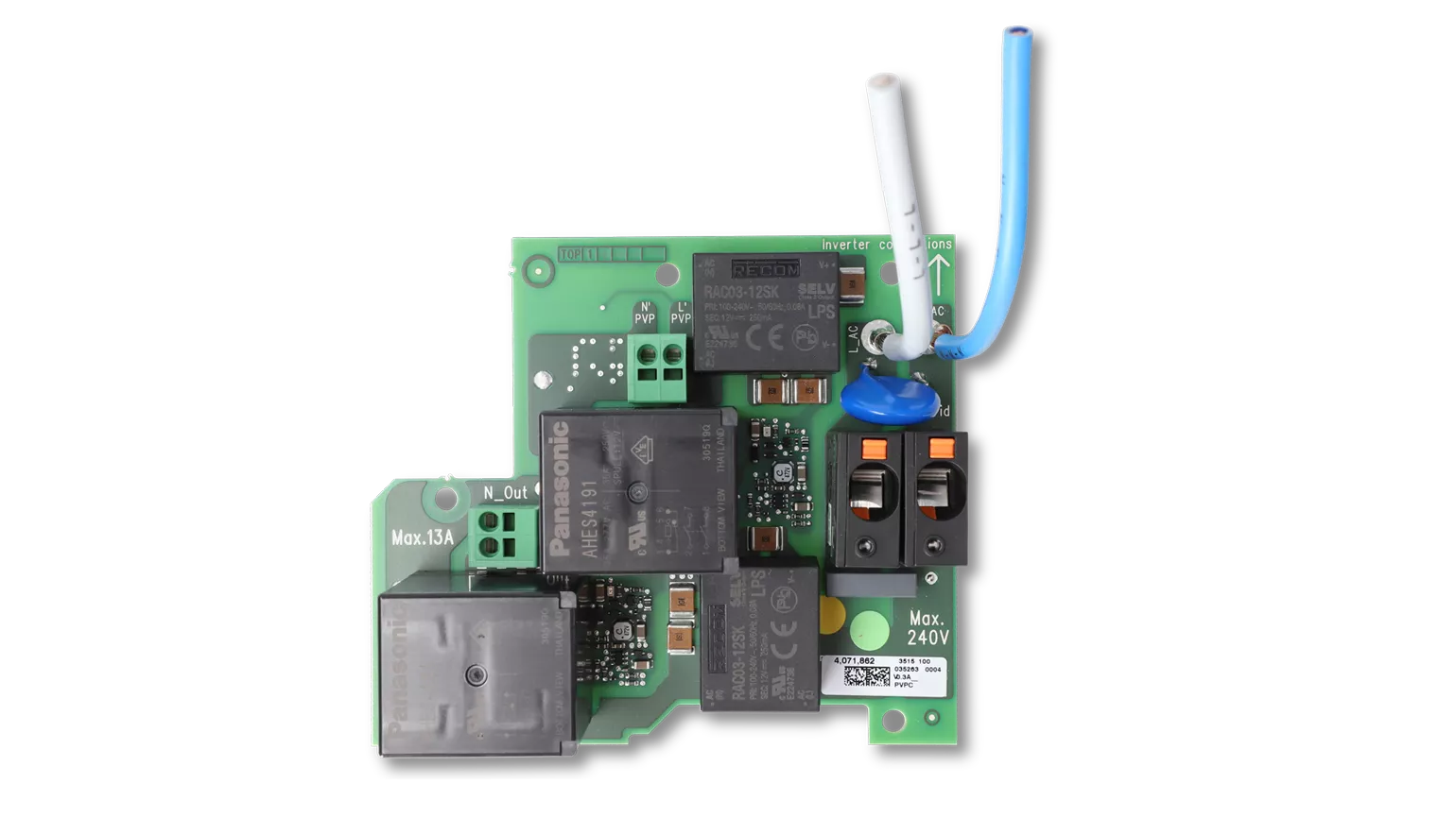

Technical Data
General Data
| Dimension / length | 103 mm |
| Dimension / width | 119 mm |
| Dimension / height | 45 mm |
| Dimension / depth | 103 mm |
| Weight | 0,32 kg |
| Weight incl. packaging | 0,41 kg |
Technical Data
| Electrical fuse | Circuit breaker 13 A1) type C & 30 mA residual current circuit breaker type A |
| Maximum amperage Primo GEN24 [Plus] (continuous operation) | 13 A |
| Maximum amperage Symo GEN24 [Plus] (continuous operation) | 13 A |
| Max. power in backup power mode Primo GEN24 [Plus] (continuous operation) | 3000 W |
| Maximum amperage Primo GEN24 [Plus] (overload - 5 seconds) | 20 A |
| Max. power in backup power mode Symo GEN24 [Plus] (continuous operation) | 3000 W |
| Maximum amperage Symo GEN24 [Plus] (overload - 5 seconds) | 18 A |
| Max. power in backup power mode Symo GEN24 [Plus] (overload - 5 seconds) | 4100 W |
| Max. power in backup power mode Primo GEN24 [Plus] (overload - 5 seconds) | 4700 W |
| Grid connection | NPE |
