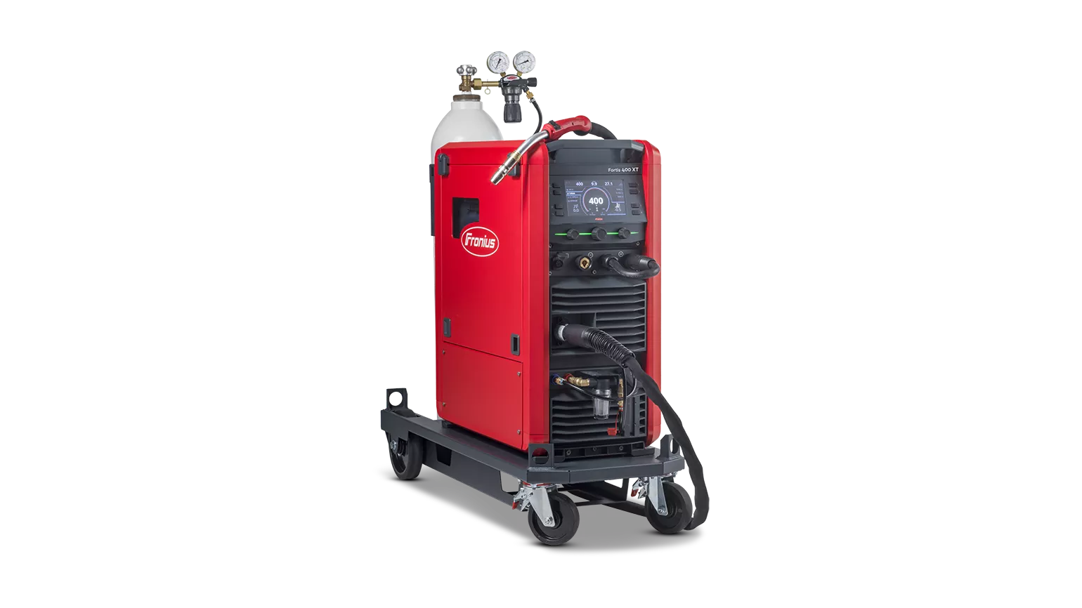

Technical Data
General Data
| Welding current min. | 3 A |
| Welding current max. | 400 A |
| Number of phases | 1 & 3 |
| Welding current / Duty cycle [10min/40°C] | 400 A / 40 % |
| Welding current / Duty cycle [10min/40°C] | 360 A / 60 % |
| Welding current / Duty cycle [10min/40°C] | 320 A / 100 % |
| Wire feed speed min. | 1 m/min |
| Wire feed speed max. | 25 m/min |
| Dimension / length | 687 mm |
| Dimension / width | 368 mm |
| Dimension / height | 763 mm |
| Weight | 43 kg |
