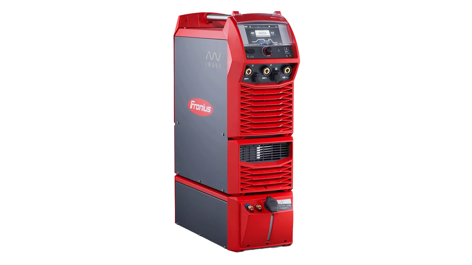

Technical Data
General Data
| Mains voltage | 3 x 400 V |
| Mains voltage tolerance | +/-15 % |
| Welding current min. | 3 A |
| Welding current max. | 400 A |
| Welding current / Duty cycle [10min/40°C] | 400A / 40% |
| Welding current / Duty cycle [10min/40°C] | 360A / 60% |
| Welding current / Duty cycle [10min/40°C] | 400 A / 40 % |
| Welding current / Duty cycle [10min/40°C] | 360 A / 60 % |
| Welding current / Duty cycle [10min/40°C] | 320 A / 100 % |
| Welding current / Duty cycle [10min/40°C] | 320A / 100% |
| Operating voltage min. | 10,1 V |
| Open-circuit voltage | 96 V |
| Dimension / length | 706 mm |
| Dimension / width | 300 mm |
| Dimension / height | 740 mm |
| Weight | 68,8 kg |
| Weight incl. packaging | 72,2 kg |
| Interference emission class | A |
| Welding process | Metall-Inertgas |
| Mains cable included | Yes |
| Earth connection | Dinse |
| Length of mains cable | 5000 mm |
| Maximum working voltage | 48,7 V |
