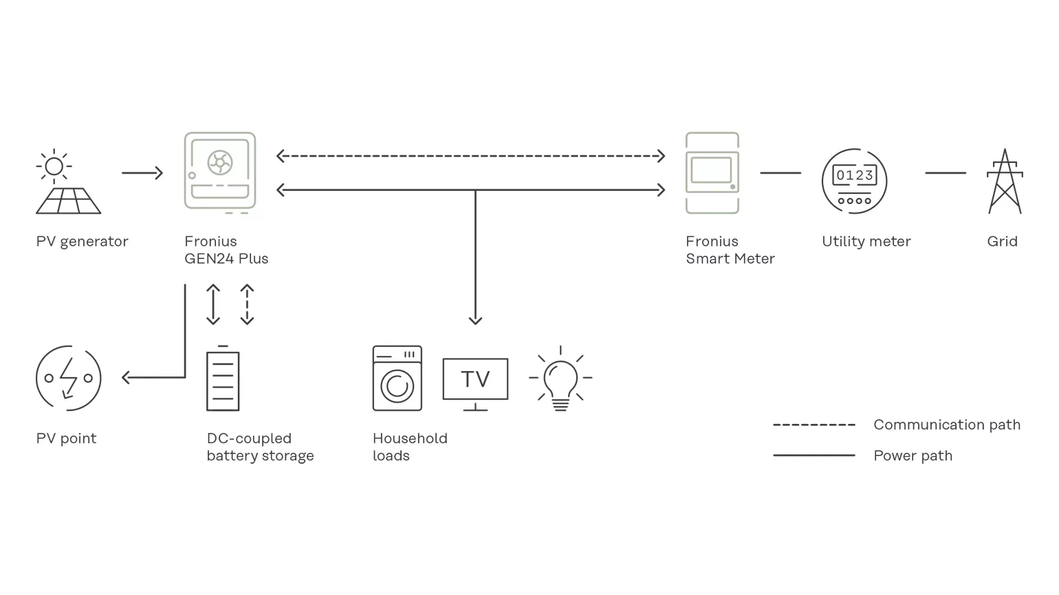

    Basic Backup Power Supply with the PV Point
    The PV Point provides an integrated basic backup power supply for the Fronius GEN24 and Fronius GEN24 Plus. During a power failure, single-phase electrical loads up to 3 kW are supplied via a fused socket or a fused circuit. For even greater convenience, the PV Point Comfort ensures that selected electrical appliances are continuously supplied with power both in parallel grid operation and during a power failure. This accessory product can be easily retrofitted as a PC board in the inverter. The cabling of both solutions must be protected with a type A 30 mA RCD, plus a 13 A automatic circuit breaker for the PV Point Comfort.

    Basic backup power supply
    The PV Point is a backup power solution integrated into the inverter that supplies current to single-phase loads up to 3 kW via a fused socket or a fused circuit. Backup power management with the PV Point Comfort has the advantage that the connected loads are continuously supplied with power, including in parallel grid operation.

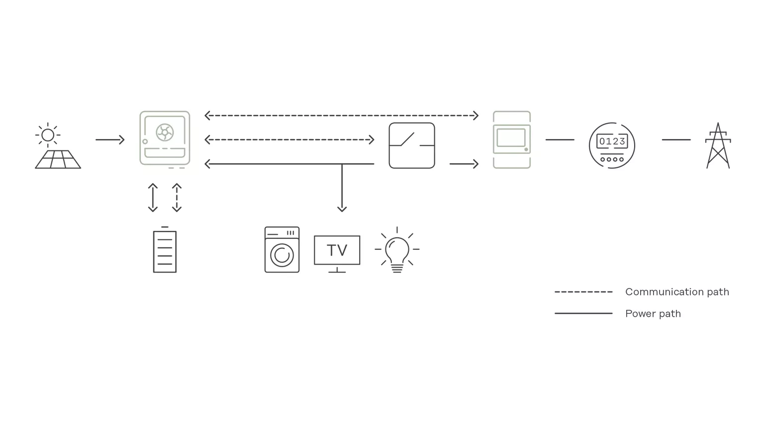

    Full Backup
    In the event of grid failure, the hybrid inverter automatically disconnects the household from the grid. Energy for the entire household is then provided by the PV system and the battery storage system (as long as enough power is available). Our hybrid inverters and the Fronius Smart Meter ensure that the household remains disconnected from the grid until the fault is rectified and normal operation is restored.

    PV Point
    • An integrated basic backup power supply that supplies current to single-phase loads via a fused socket.
    PV Point Comfort
    • A PC board that can be retrofitted to the inverter to supply single-phase loads via a fused socket, including in parallel grid operation.
    Backup Switch*
    • A cost-effective, space-saving 3-way switch for manual activation of Full Backup mode
    • Available as Fronius Backup Switch 1P/3P-63A & Fronius Backup Switch 1PN/3PN-63A
    • *Depending on country-specific certification and availability
    Backup Controller*
    • A switch unit that automatically switches to Full Backup mode and back to normal operation
    • Available as Fronius Backup Controller 3P-35A
