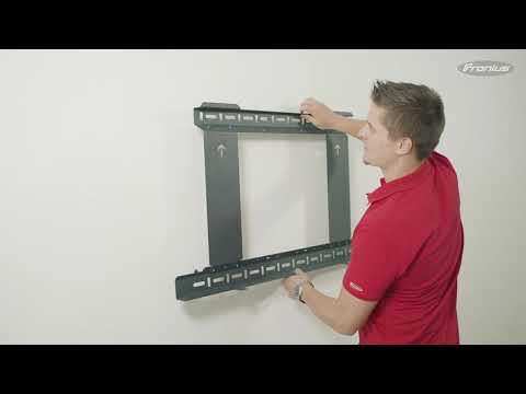

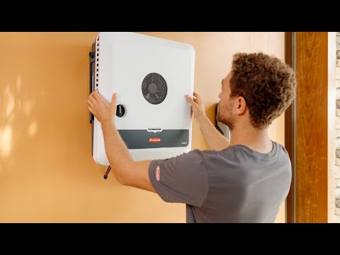

Installation
In our clear installation video, we show you how to install the Fronius Tauro in a quick and easy way.

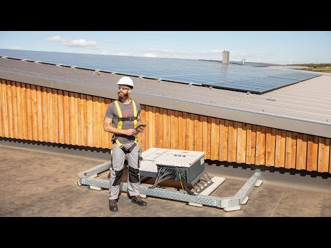

    Commissioning
    Commissioning with just one click
    The new Tauro Commercial inverters can be commissioned via PC as well as with the practical Fronius Solar.start App. In just three steps, you can complete the commissioning process via the app and connect the inverter to the network quickly and easily.
    Fronius Tauro – Commissioning

    Password forgotten
    The local user interface of the inverter is protected by a Customer & Technician password.
    Using the "Recovery Key" function in Fronius Solar.SOS, you can generate the unlock code to reset the Customer & Technician password of your device.
    The password can be reset as follows:
    • Click "Forgot Password" on the inverter's user interface to generate a PIN.
    • Go to "Recovery key" on Fronius Solar.SOS and fill in the mandatory fields to generate an unlock code.
    • On the user interface of the inverter, enter the generated unlock code and set your new password.
    Please note: In order to be able to generate an unlock code, you need plant maintenance or owner rights for the device on Solar.web.
    How-To Video: Password Recovery for GEN24/Tauro with Solar.SOS
