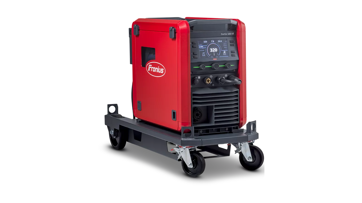

Fortis MIG/MAG
Technical Data
General Data
| Welding current min. | 3 A |
| Welding current max. | 320 A |
| Operating voltage min. | 14,2 V |
| Open-circuit voltage | 80 V |
| Dimension / length | 687 mm |
| Dimension / width | 368 mm |
| Dimension / height | 555 mm |
| Weight | 37,83 kg |
| Weight incl. packaging | 43,49 kg |
| Interference emission class | A |
| Mains fuse | 16 A |
| S-Zeichen | Yes |
| Netzspannungstoleranz Minus | 10 % |
| Netzspannungstoleranz Plus | 6 % |
| Mains voltage | 460 V |
| Maximum working voltage | 42,2 V |
| Energieverbrauch im Leerlauf | 29,4 W |
Technical Data
| Operating voltage maximum | 30 V |
| Mains voltage | 230 V |
| Power Factor (pf) | 0.99 |
