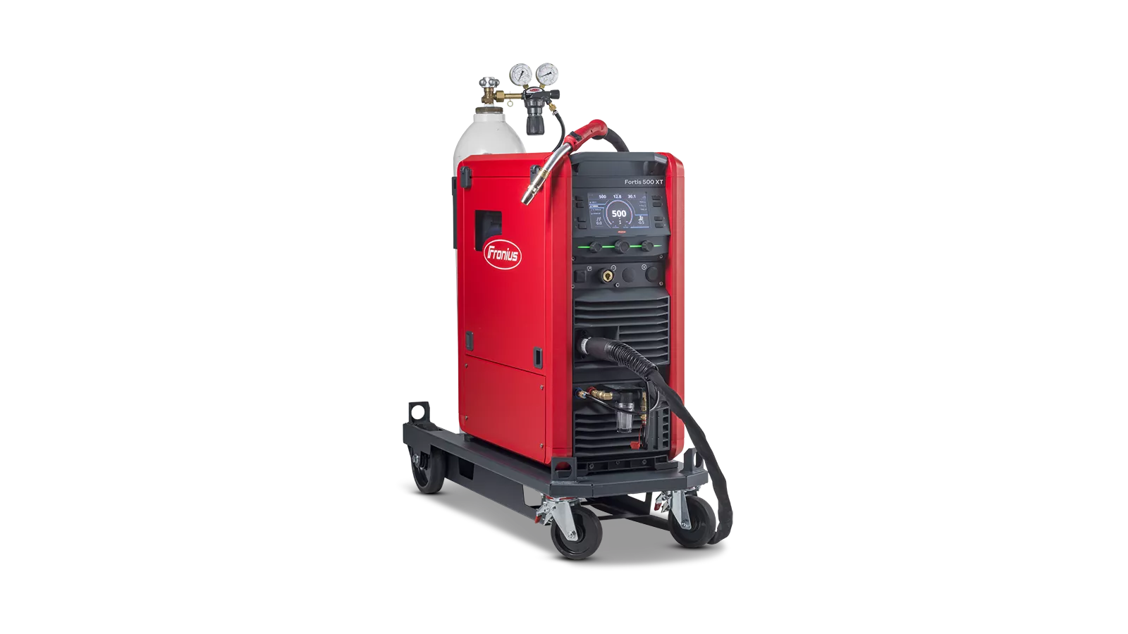

Fortis MIG/MAG
Technical Data
General Data
| Welding current min. | 3 A |
| Welding current max. | 500 A |
| Operating voltage min. | 14,2 V |
| Open-circuit voltage | 80 V |
| Dimension / length | 687 mm |
| Dimension / width | 368 mm |
| Dimension / height | 763 mm |
| Weight | 43,02 kg |
| Weight incl. packaging | 49,18 kg |
| Interference emission class | A |
| Schweißstrom 2 (bei 40°C) | 500 A |
| Schweißstrom 2 (bei 40°C) | 460 A |
| Schweißstrom 2 (bei 40°C) | 360 A |
| Maximum working voltage | 49,6 V |
Technical Data
| Power Factor (pf) | 0.99 |
