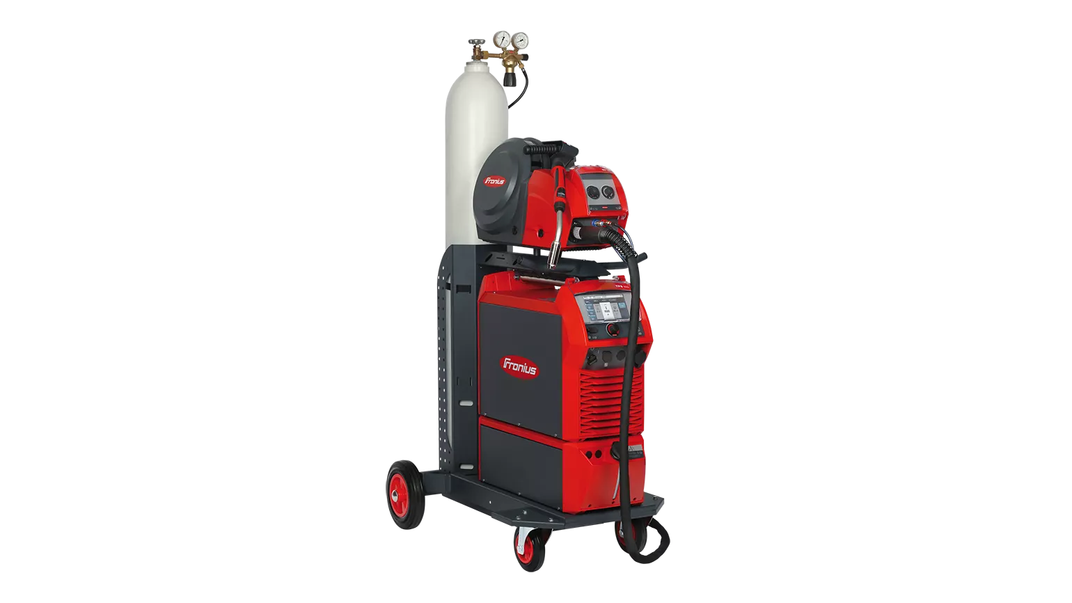

TPS/i
Technical Data
General Data
Mains voltage3 x 400V
Mains Frequency50-60Hz
Welding current min.3 A
Welding current max.600 A
Welding current / Duty cycle [10min/40°C]600A / 60%
Welding current / Duty cycle [10min/40°C]500A / 100%
Open-circuit voltage74 V
Degree of protectionIP23
Dimension / length706 mm
Dimension / width300 mm
Dimension / height510 mm
Weight50 kg

Function overview
  TPS 320i TPS 400i  TPS 500i  TPS 600i
Mains voltage
3 x 400 V
3 x 380 – 460 V (/nc)
3 x 575 V (/600V/nc)
3 x 200 – 460 V (/MV/nc)
3 x 400 V
3 x 400 V
3 x 400 V
Mains frequency 50 – 60 Hz
Cos phi 0,99
MIG/MAG welding current range
3 – 320 A 3 – 400 A 3 – 500 A  3 – 600 A
10 min/40°C (104°F)40% D.C 320 A 400 A 500 A 600 A
10 min/40°C (104°F)60% D.C 260 A 360 A  430 A 600 A
10 min/40°C (104°F)100% D.C 240 A 320 A 360 A  500 A
Open circuit voltage
73 V
84 V (/nc)
67 V (/600V/nc)
68 V (/MV/nc)
75 V
83 V (/nc)
68 V (/600V/nc)
67 V (/MV/nc)
71 V
82 V (/nc)
71 V (/600V/nc)
68 V (/MV/nc)
71 V
85 V (/nc)
73 V (/600V/nc)
MIG/MAG working voltage 14,2 – 30 V 14,2 – 34 V 14,2 – 39 V  14,2 – 44 V
Protection class IP23
Dimensions l x w x h 706 x 300 x 510 mm
