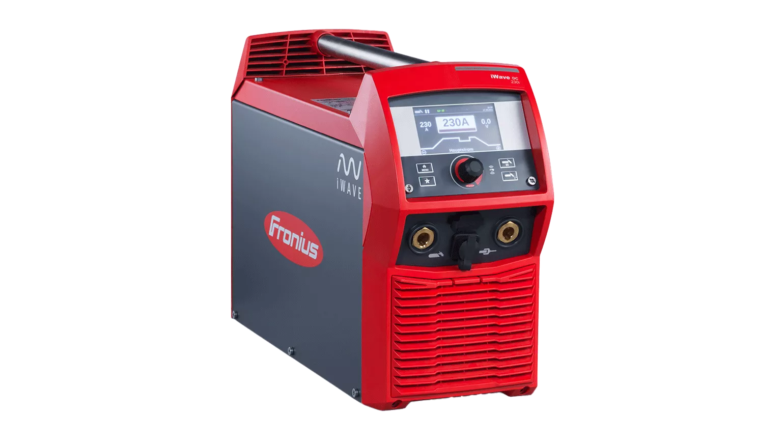

iWave TIG
Technical Data
General Data
| Mains voltage | 230 V |
| Mains voltage tolerance | +/-15 % |
| Mains Frequency | 50-60Hz |
| Welding current min. | 3 A |
| Welding current max. | 230 A |
| Welding current / Duty cycle [10min/40°C] | 230A / 45% |
| Welding current / Duty cycle [10min/40°C] | 205A / 60% |
| Welding current / Duty cycle [10min/40°C] | 170A / 100% |
| Operating voltage min. | 10,1 V |
| Open-circuit voltage | 97 V |
| Dimension / length | 558 mm |
| Dimension / width | 210 mm |
| Dimension / height | 369 mm |
| Weight | 16,4 kg |
| Weight incl. packaging | 20,5 kg |
| Interference emission class | A |
| Length of mains cable | 2500 mm |
