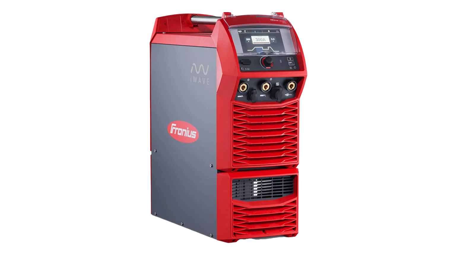

Welding with the iWave
The intelligent TIG welding system
The Fronius TIG welding system that makes no compromises
Precise. Durable. Intuitive. With the iWave series, not only can you smash everyday welding tasks; you can also unleash your welding potential and make yourself future-proof. Flexible.
Video: Full freedom - to unleash your welding potential
Top quality – for every weld and every material: with its targeted heat input and improved ignition function, iWave gives you maximum control over your arc while significantly reducing ignition delays.

TIG
iWave 190i-500i
The intelligent TIG welding system for industrial applications and outstanding quality whatever the materials involved.
  • iWave DC:230i/300i/400i/500i
  • iWave AC/DC: 190i/230i/300i/400i/500i
