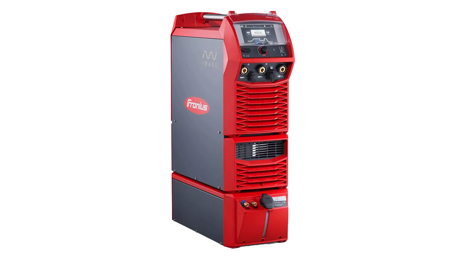

Fronius iWave
The intelligent TIG welding machine
Fronius iWave: outstanding performance in every TIG application
The iWave’s targeted heat input and improved ignition function give you precise control over the arc and significantly reduce ignition delays, resulting in reliable quality for every weld seam and every material.

CycleTIG
For targeted heat input
CycleTIG is based on the principle of stitch welding. Compared to standard pulse welding it offers additional setting options and new parameter combinations for improved welding results.
  • Outstanding weld seam appearance
    Supported by the tacking function
  • Targeted heat input
    Ideal for thin-sheet welding and edge applications
  • Easy weld pool control
    No burn through, even on corner and butt welds
  • Fewer temper colors
    For sensitive application areas
  • Easy handling
    For clean weld seams
Stable and reproducible TIG ignition
The iWave significantly improves ignition behavior during TIG welding. We have optimized the HF ignition process and adapted it to suit various electrode diameters.
RPI auto* reduces ignition delays by up to 71%**
With the RPI auto function, the welding machine automatically adjusts the ignition settings. This ensures fast and reproducible ignitions, even under variable conditions or as ignition performance declines, without any manual intervention.
* Only for iWave AC/DC
** Compared to RPI off | Test series conducted under laboratory conditions: 200 A welding current / 0.5 s welding time / 1000 ignitions
