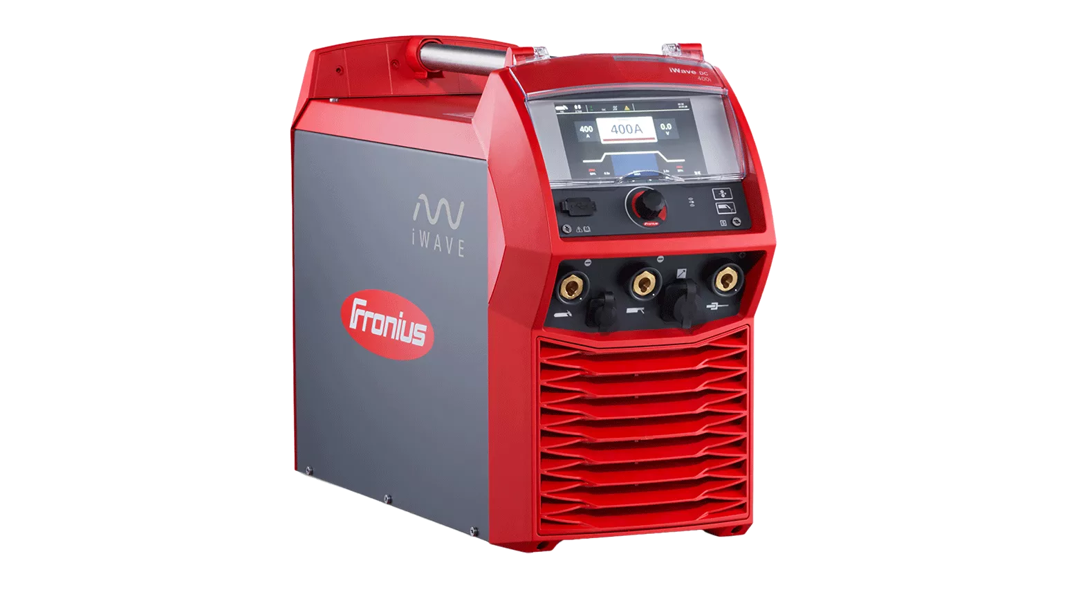

iWave TIG
Technical Data
General Data
Mains voltage | 3 x 400 V |
Mains voltage tolerance | +/-15 % |
Welding current min. | 3 A |
Welding current max. | 400 A |
Welding current / Duty cycle [10min/40°C] | 400A / 40% |
Welding current / Duty cycle [10min/40°C] | 360A / 60% |
Welding current / Duty cycle [10min/40°C] | 320A / 100% |
Operating voltage min. | 10,1 V |
Open-circuit voltage | 96 V |
Degree of protection | IP23 |
Dimension / length | 706 mm |
Dimension / width | 300 mm |
Dimension / height | 510 mm |
Weight | 49,9 kg |
Weight incl. packaging | 52,6 kg |
Interference emission class | A |
Mains cable included | Yes |
Earth connection | Dinse |
Length of mains cable | 5000 mm |
Maximum working voltage | 51,1 V |
