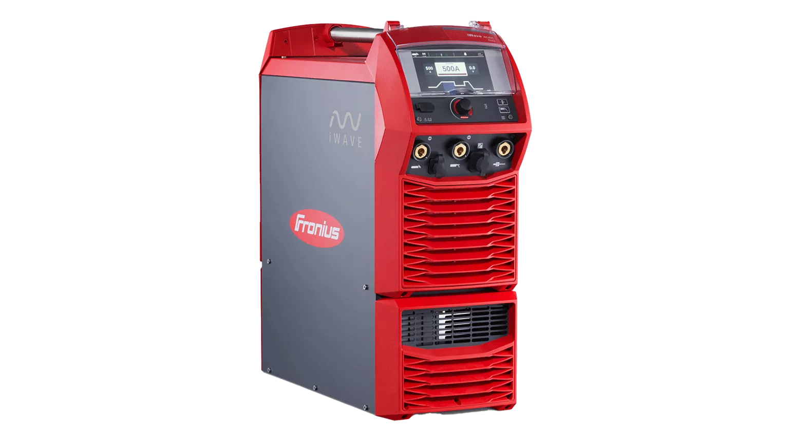

Fronius iWave
The intelligent TIG welding machine
Fronius iWave: outstanding performance in every TIG application
The iWave’s targeted heat input and improved
ignition function give you precise control over the arc and significantly
reduce ignition delays, resulting in reliable quality for every weld seam and
every material.

The iWave welding machine variants at a glance
| iWave 190i AC/DC | iWave 230i DC or iWave 230i AC/DC | iWave 300i DC or iWave 300i AC/DC | iWave 400i DC or iWave 400i AC/DC | iWave 500i DC or iWave 500i AC/DC |
| 3–190 A (TIG) | 3–230 A (WIG) | 3–300 A (TIG) | 3–400 A (TIG) | 3–500 A (TIG) |
| 230 V single-phase or 120–230 V single-phase (MV) | 230 V single-phase or 120–230 V single-phase (MV) | 400 V three-phase or 200–600 V three-phase (MV) | 400 V three-phase or 200–600 V three-phase (MV) | 400 V three-phase or 200–600 V three-phase (MV) |
| Gas-cooled | Gas-cooled or water-cooled | Gas-cooled or water-cooled | Gas-cooled or water-cooled | Gas-cooled or water-cooled |
| TIG, MMA | TIG, MMA | TIG, MMA, and MIG/MAG (all WPs) | TIG, MMA, and MIG/MAG (all WPs) | TIG, MMA, and MIG/MAG (all WPs) |
| Connectivity (Wi-Fi, Bluetooth, NFC) as standard | Connectivity (Wi-Fi, Bluetooth, NFC) as standard | Connectivity (Wi-Fi, Bluetooth, NFC) as standard | Connectivity (Wi-Fi, Bluetooth, NFC) as standard | Connectivity (Wi-Fi, Bluetooth, NFC) as standard |
| Ethernet optional | Ethernet optional | Ethernet and SpeedNet as standard | Ethernet and SpeedNet as standard | Ethernet and SpeedNet as standard |
