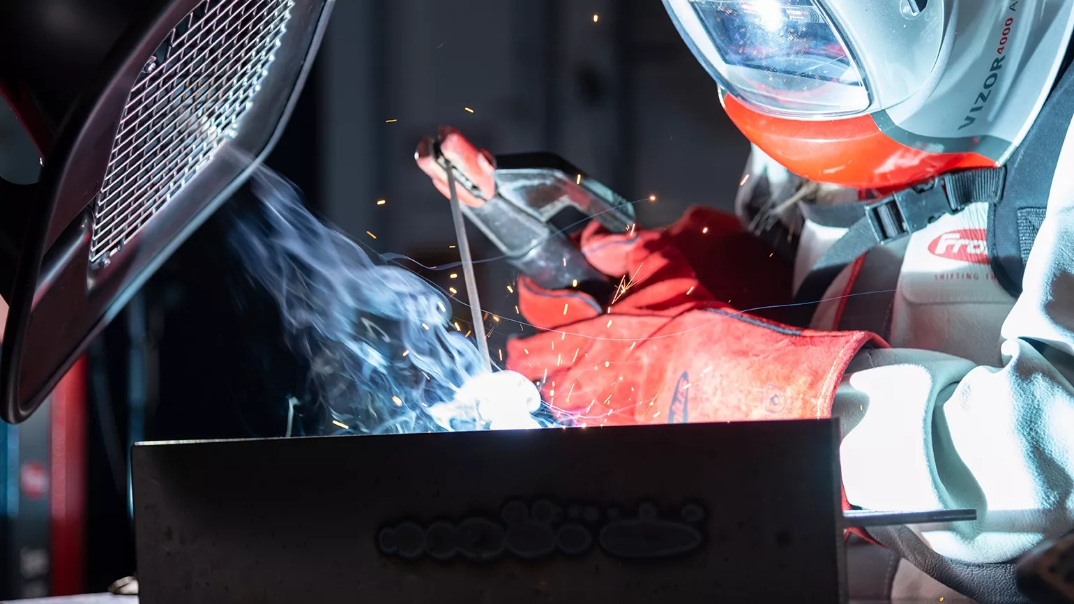

Exento LowVac
Low vacuum extraction
In the comparison test, the low vacuum extraction system with flexibly adjustable extraction arm and extraction hood ensured a significant reduction in welding fumes. However, the extraction arm must always be in the correct position. In contrast to the PAPR system, all welding personnel are protected.
