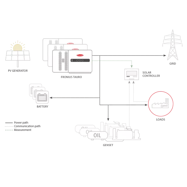

    Fronius PV-Genset Advanced
    With the PV-Genset Advanced solution, PV systems can be easily and quickly integrated into diesel systems in which several diesel generators are being used. The Advanced solution is primarily designed as a retrofit solution for multi-generator systems. The controller is the communication interface and assumes perfect control of the entire system. The PV system can thus relieve the workload of the diesel generators as much as possible and save costs. A striking feature of this solution is the combination and compatibility of strong partners such as ComAp, DEIF, Elum or Encombi.
    • The retrofit solution for multi-generator systems
    • Suitable for both low-voltage and medium-voltage applications
    Fronius PV-Genset Professional
    The PV-Genset Professional is the fully integrated and harmonised solution for multi-generator systems. The controller is the communication interface and assumes perfect control of the entire system. This results in optimum interaction and relieves the workload from the diesel generators in the best possible way through the PV system. A striking feature of this solution is the combination and compatibility of strong partners such as ComAp or DEIF.
    • The fully integrated solution for multi-generator systems

    To ensure stable operation of your PV-Genset system, not only the integrated components are essential, but also their smart control: It ensures smooth operation and also ensures maximum yields and noticeable savings in energy costs.
    The solar controller is the communication interface and is responsible for the flawless control of the entire system. Thanks to the integrated Fronius communication unit, third-party components are easy to integrate into a control unit using Modbus RTU or via TCP using the SunSpec inverter control model.
    Inverter Solar Controller

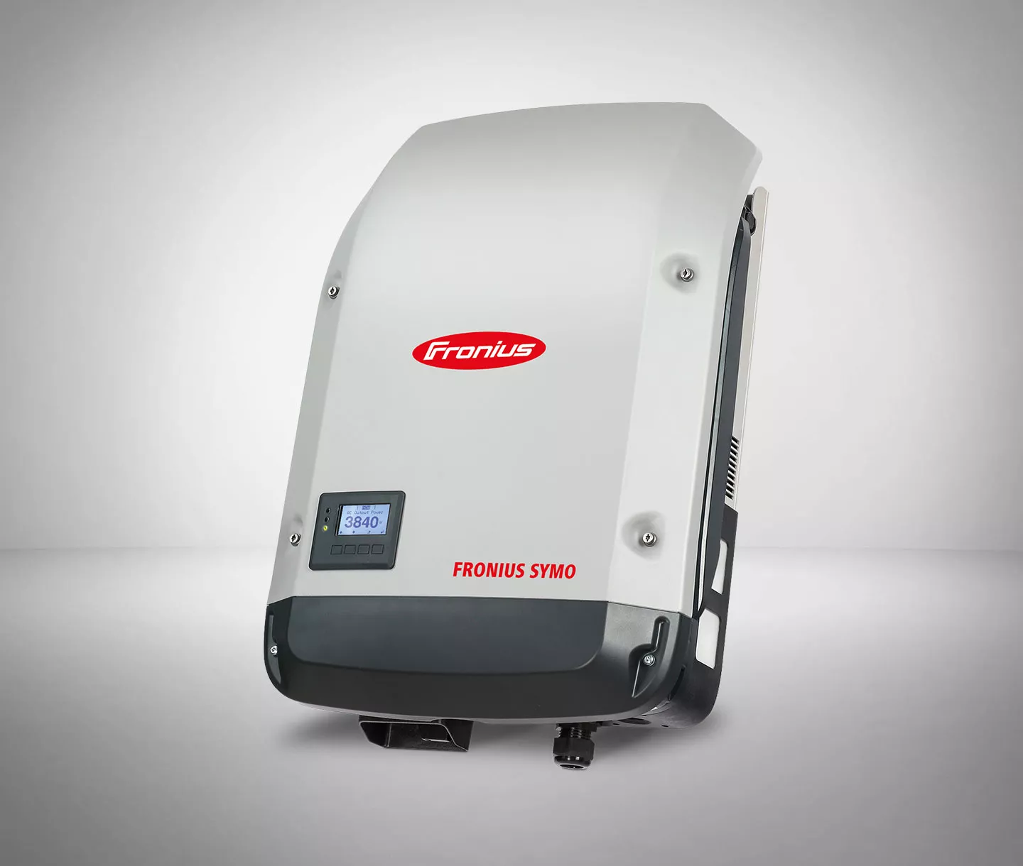

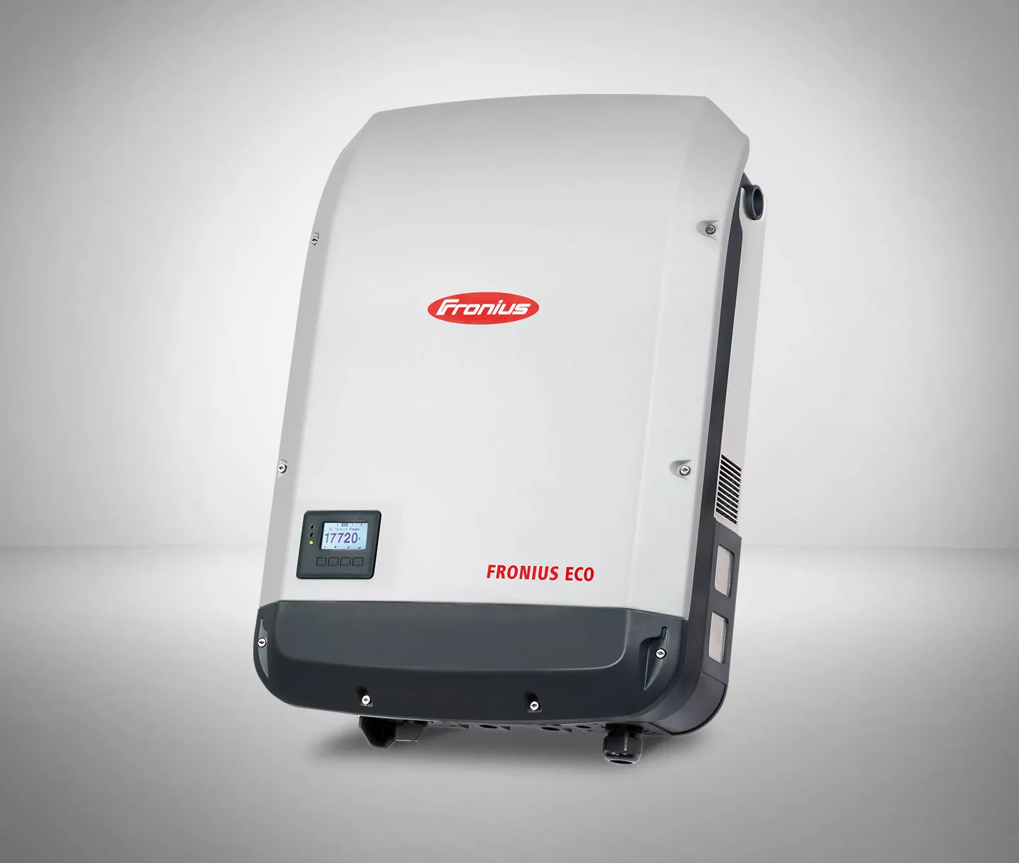

    Fronius SnapINverter
    (Symo, Symo Advanced, Eco)
    Elum (ePowerControl),
    ENcombi (ECpv)

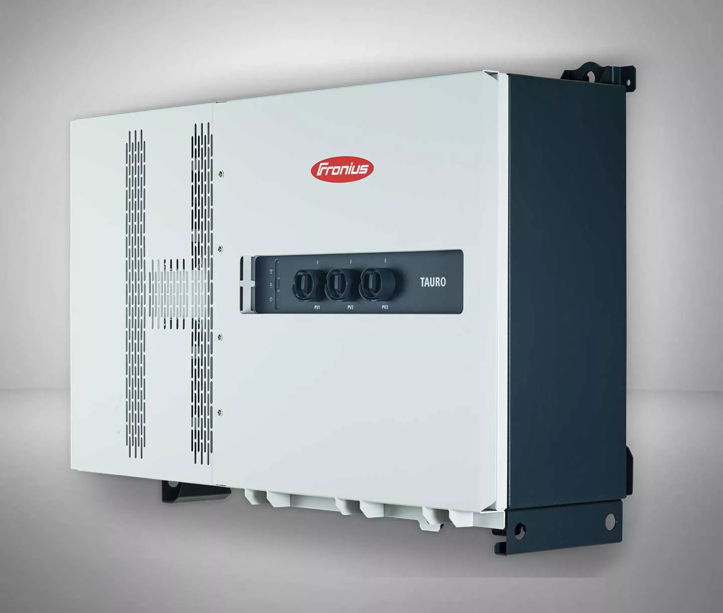

    Fronius Tauro
    (Tauro, Tauro ECO)
     DEIF (ASC)
     Fronius GEN24 Plus  ComAp (InteliSys)
