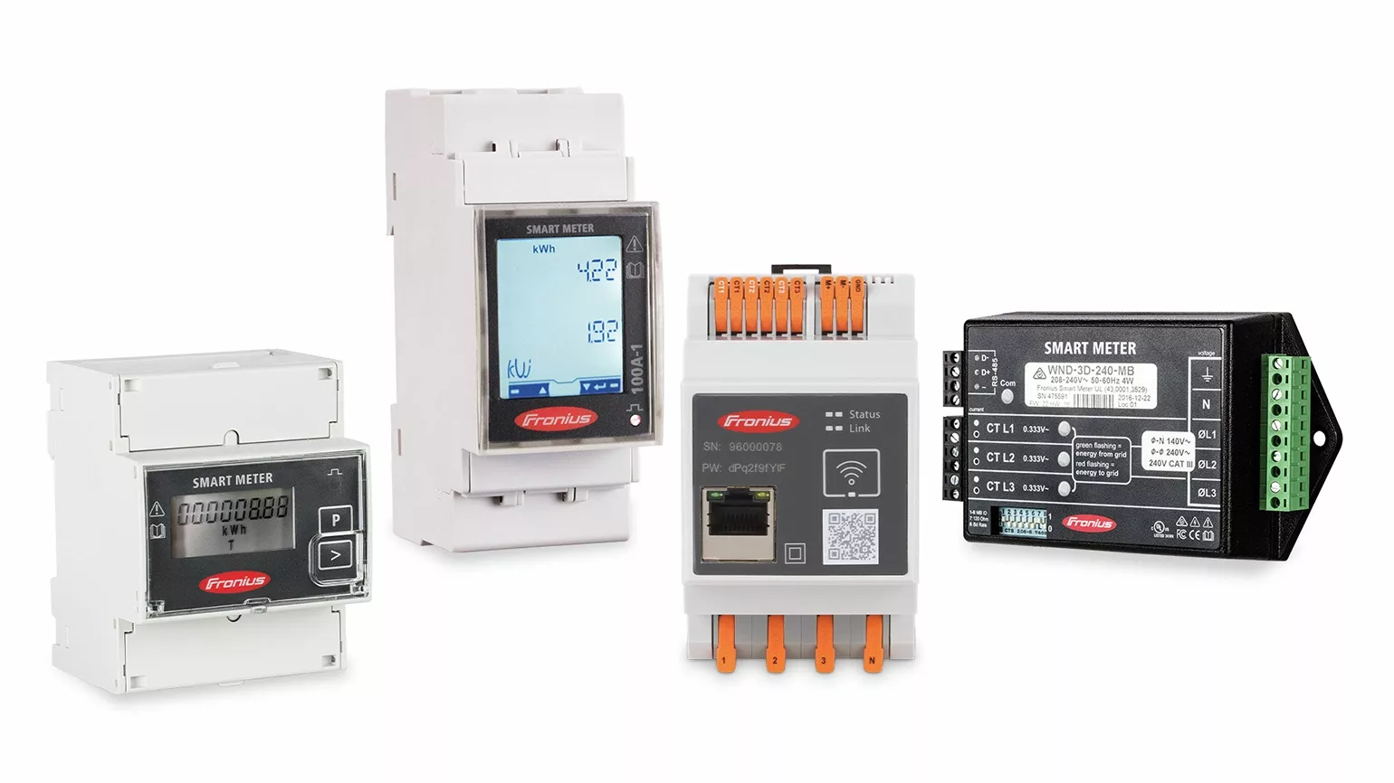

Recording, understanding, and optimizing energy flows is only possible if the correct data is available. The Fronius Smart Meter is our bidirectional electricity meter for precisely recording how much electricity you consume as well as current drawn from or fed into the grid. It is an essential component of the Fronius energy system and enables intelligent load and energy management for domestic and commercial users.

Single-phase, three-phase, for high currents, or with WiFi—there is a suitable Smart Meter for every application
Optimize your self-consumption
The Smart Meter provides the basis for your efficient energy management with a battery, Wattpilot, or Ohmpilot
Easy installation
Thanks to push-in spring clamps (for the IP series) or DIN rail mounting and its compact design, the Fronius Smart Meter can be installed quickly and easily in any control box
Flexible communication
Modbus RTU, TCP (LAN & WiFi)—depending on the model, different interfaces ensure a smooth connection to the inverter

  Smart Meter Smart Meter TS Smart Meter IP Smart Meter WR
Available models  63A-3, 63A-1 65A-3, 100A-1 5kA-3
Safety class IP 51 (front frame), IP 20 (connections) IP 51 (front frame), IP 20 (connections) IP 20 (front frame), IP 30 (connections) IP40
Interfaces RS 485 RS 485
RS 485, Modbus TCP/IP
RS 485
Regional availability Australia, New Zealand Global (excl. USA, Canada, Australia, New Zealand) Global (excl. USA, Canada)  Australia, New Zealand, Italy, UK, USA, Canada, Mexico
