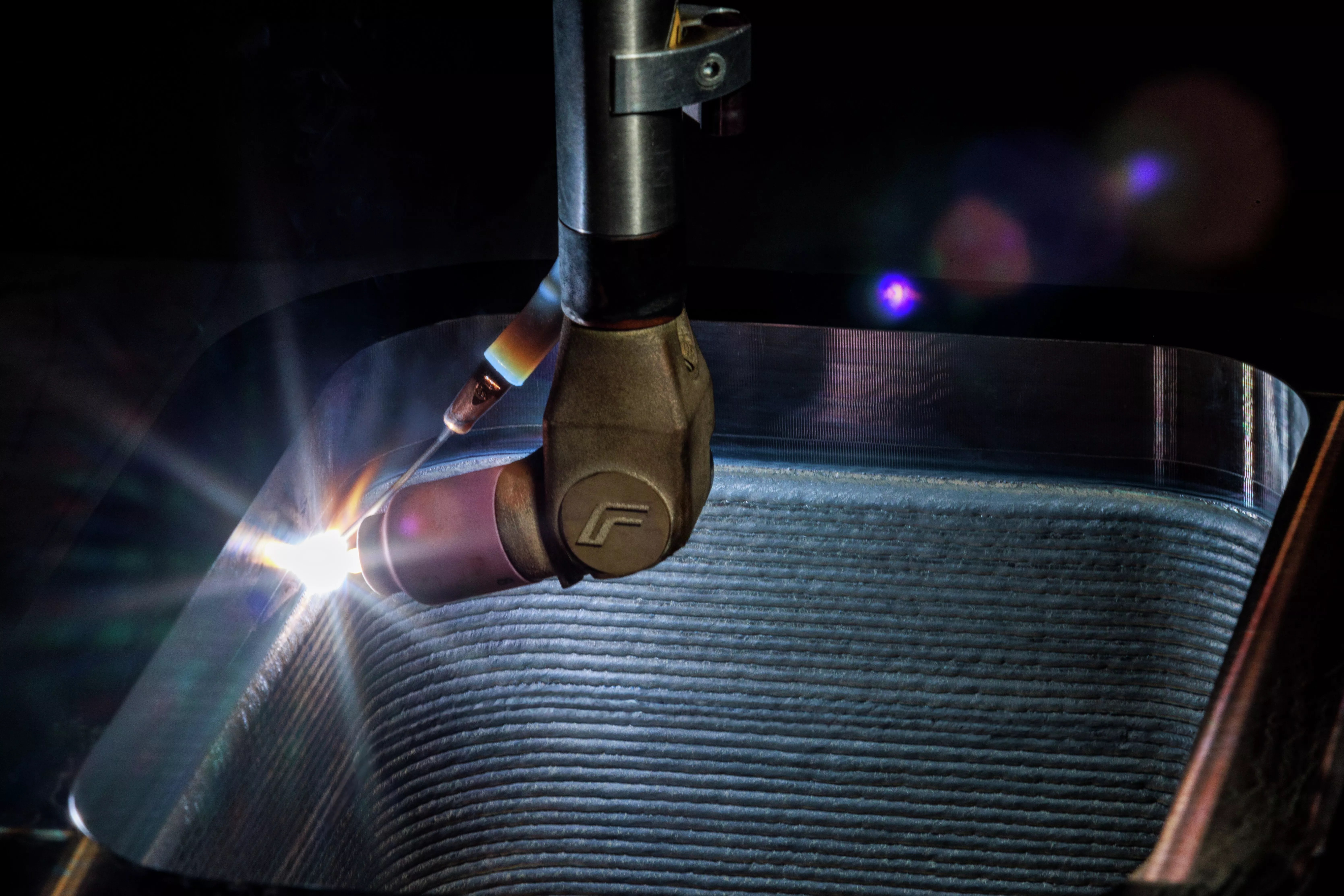

Cladding
Cladding is a process in which components are coated with special alloys in order to significantly extend their service life. This coating is applied by means of mechanized build-up welding.
Fronius Speed Cladding makes the coating process up to three times faster and more efficient than conventional methods. The result: shorter production times, lower costs, and a consistently high quality protective coating.

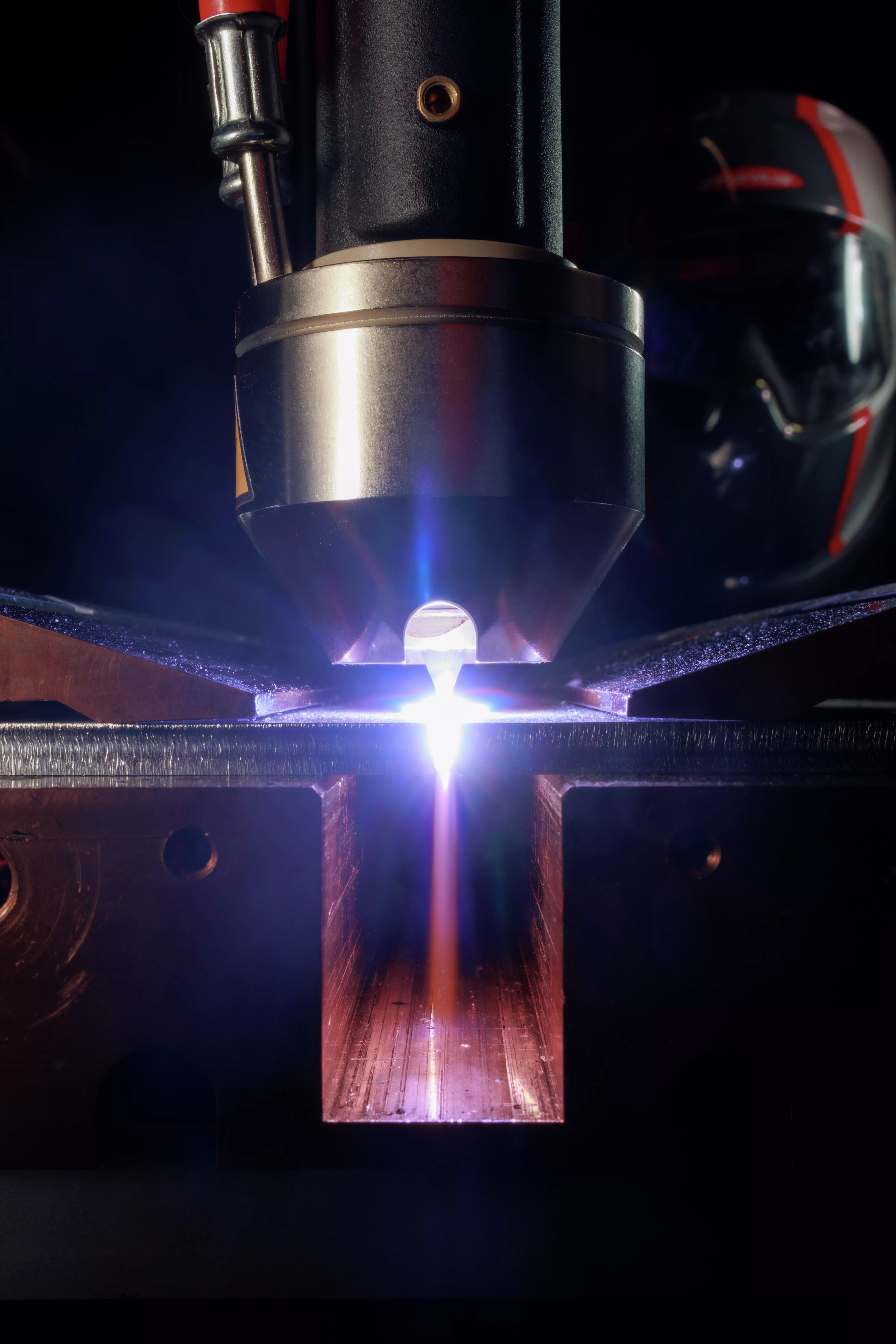

ArcTig
ArcTig is a TIG welding process for mechanized joint welding that combines the highest seam quality with maximum cost-effectiveness. It ensures an excellent seam appearance and reliable root penetration. ArcTig enables high welding speeds and reduces the effort required for seam preparation – ideal for applications where precision and efficiency are required.

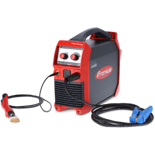

Ignis 180 TIG
  • Ultra-light TIG welding system
  • Good ignition characteristics for touchdown ignition
  • Can be updated for other functions

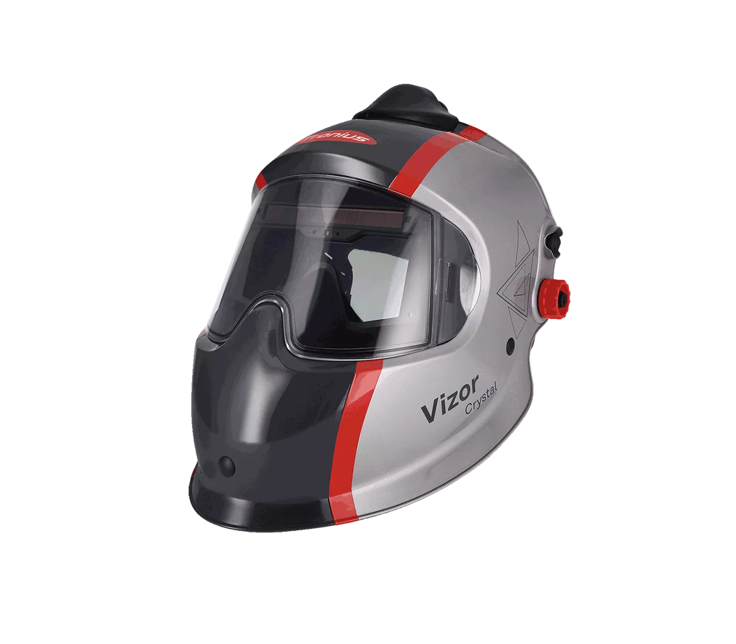

Protective clothing for welders
Spending an entire day at the welding table is stressful. The UV radiation and the welding fumes are just some of the factors that can be dangerous if you do not have the right protection. The correct welding equipment makes the crucial difference in this area.
