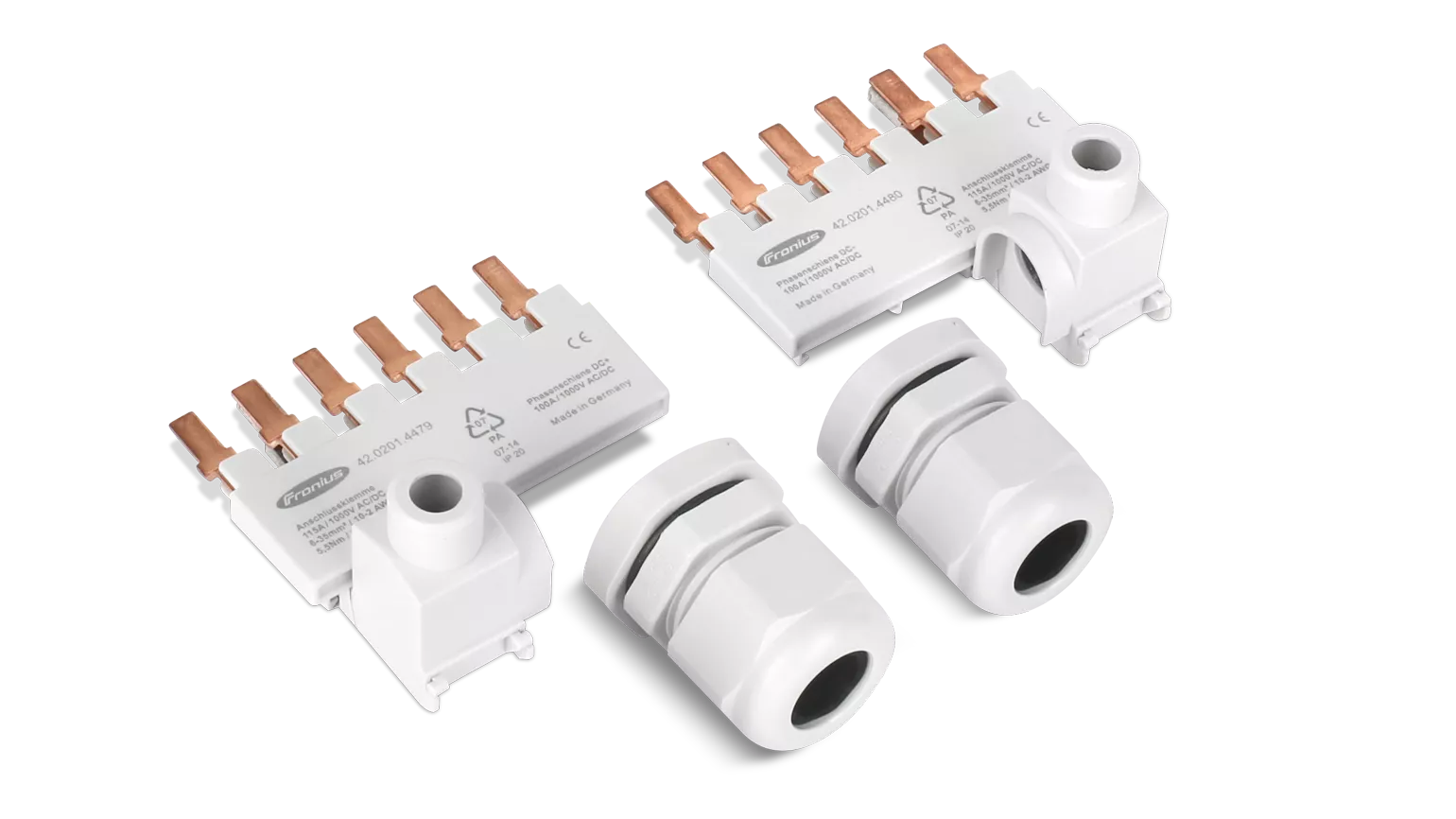

Optional retrofittable surge protection devices are available for Fronius SnapINverters as follows:
  • Type 1+2: Symo 3.0 - 20.0 kW, Primo 3.0 - 8.2 kW, Symo Hybrid, and Eco inverters.
  • Type 2: Symo 10.0 - 20.0 kW and Eco inverters.
Further documentation and instructions can be found in the Downloads section.
Retrofitting a surge protection device on Fronius Eco and Fronius Symo 10 – 20 kW

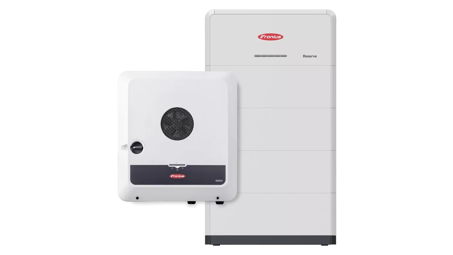

Compatible batteries & backup power
SnapINverters (Symo, Primo, Eco) do not support battery operation or backup power options. For storage solutions and backup power solutions, we recommend using a hybrid inverter such as the Fronius Verto Plus or Fronius GEN24 Plus.
An overview of the compatible batteries can be found on the battery compatibility page.
To the battery compatibility overview

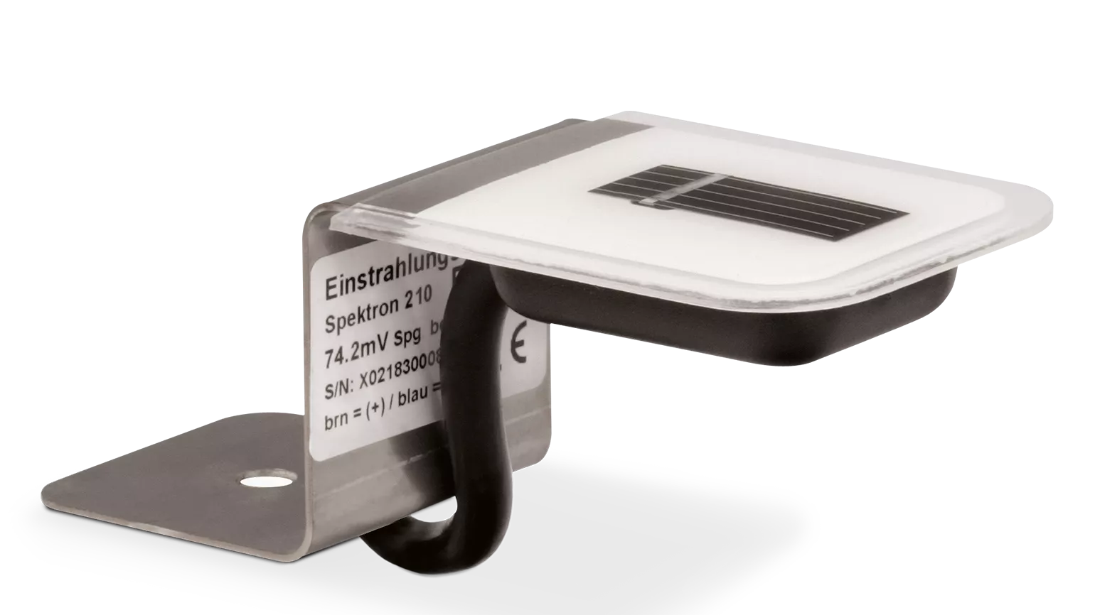

Sensors
With the Fronius Sensor Card or Fronius Sensor Box, up to six sensors for measuring irradiation, ambient temperature, module temperature, and wind speed can be integrated into the Fronius system monitoring package.
By measuring the irradiation and module temperature, it is possible to detect anomalies in the system performance quickly.
