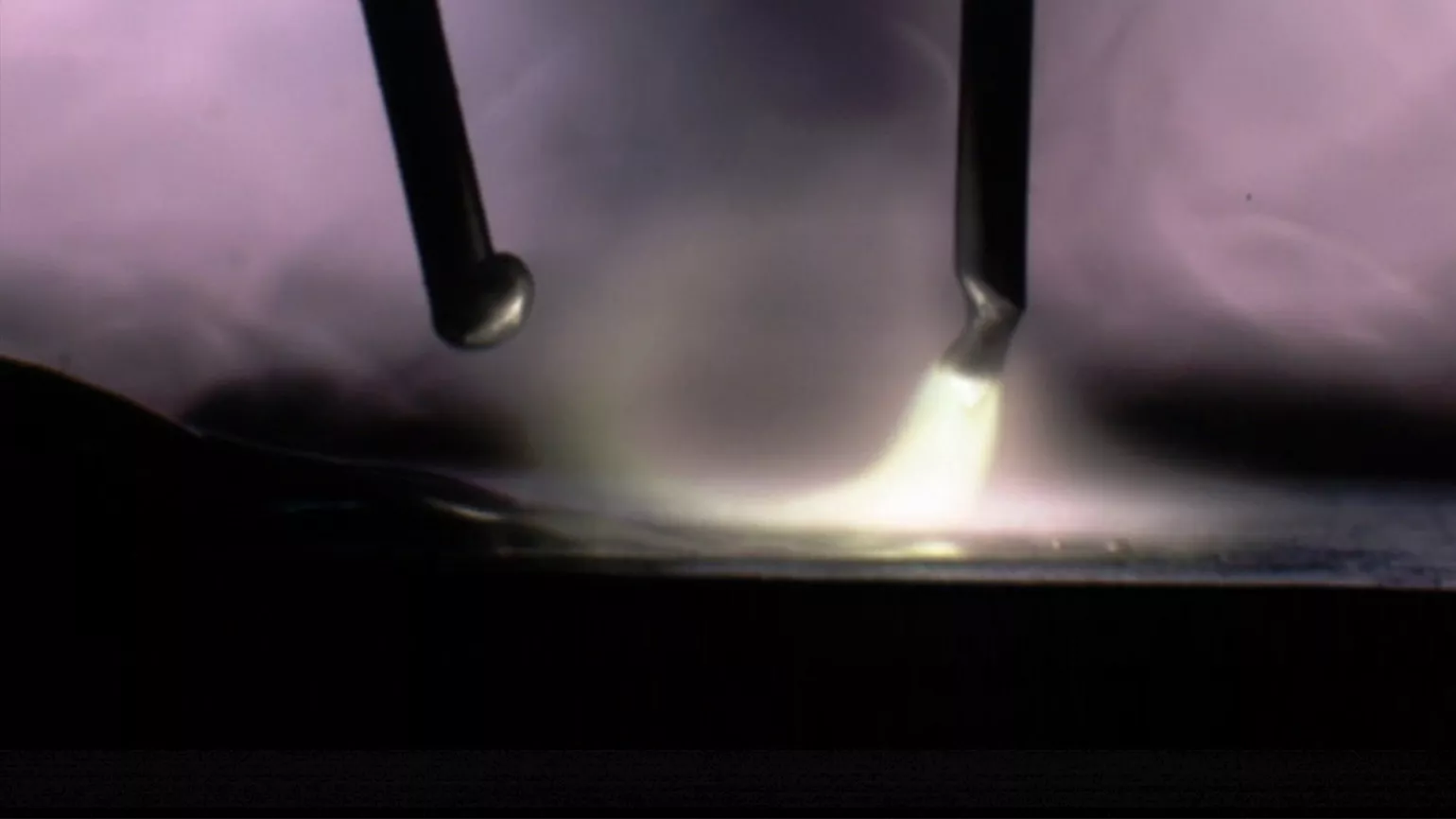

With CMT Twin, Fronius combines two independently functioning arc-welding processes into one single process. This novel twin-wire solution lets users exploit two Cold Metal Transfer (CMT) processes, or combine a CMT process with a GMA pulse welding process, all within one single system. The setup consists of two power sources, one welding torch and two separate contact tips. This innovative process technology ensures an extremely stable arc from the start of welding to the filling of the end-crater and makes it possible to weld thin sheets at high speed with minimal spatter, deep penetration and optimised weld-seam formation.
