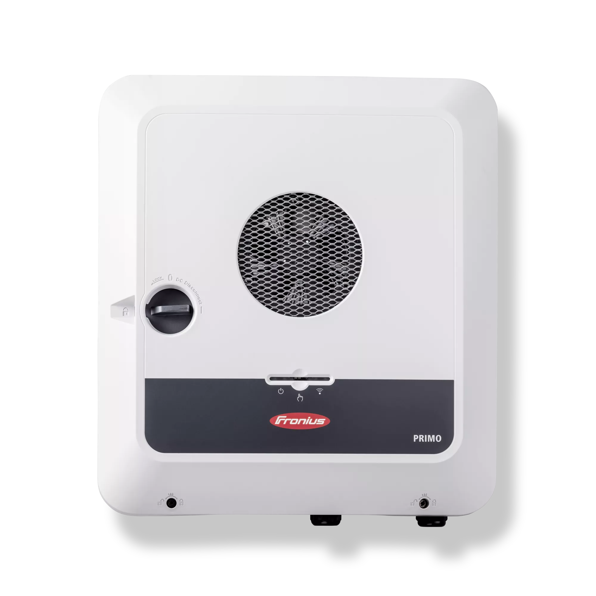

Fronius Primo GEN24
Inverters for private photovoltaic systems with integrated basic backup power function
Our single-phase Fronius GEN24 inverter is the heart of private photovoltaic systems.
The Fronius GEN24 is equipped with PV Point, an integrated basic backup power function that supplies backup power to connected devices via a protected socket (as long as the sun is shining).
The Fronius Primo GEN24 boasts a wide range of features that support a sustainable, independent energy supply. Discover the key features for installers and their customers:
/ Intelligent energy management
/ Active cooling technology for a longer service life
/ Flexible and fast installation
/ Easy integration and management of Fronius or third-party components thanks to open interfaces
