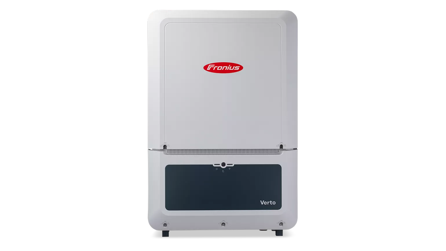

Verto—the flexible inverter
The Fronius Verto is our next-gen hybrid inverter for residential and commercial use.
It combines maximum efficiency, flexible system integration, and modern design with simple installation.
Fronius Verto Plus goes a step beyond the basic model to include battery operation and backup power functions, both of which can be activated directly through the system’s software.
Key features:
  • Hybrid inverter designed for modular expansion
  • Integrated communication module (LAN/WiFi)
  • Compatible with Fronius Smart Meter, Solar.web, and Solar.SOS
  • Optional surge protection device type 1+2
  • Full Backup option for single-phase and three-phase systems (Verto Plus only)
Note: The Verto product line is manufactured in Europe and complies with the current EN 50549 standards as well as our Fronius “Made in Austria” quality standards.
