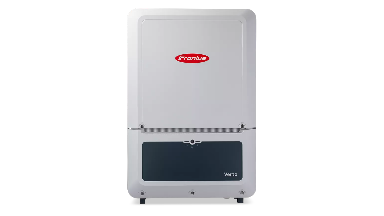

Fronius Verto
Your photovoltaic system can do more
Fronius Verto, the adaptable inverter for small businesses, agriculture and apartment blocks. Its flexibility makes it the perfect choice both for the construction of a new PV system and for an extension. With integrated safety features and innovative shading management, the Fronius Verto ensures optimum operation. Sector coupling is made possible by our flexible inverter with its open interfaces. Charging boxes such as Fronius Wattpilot or consumption controllers such as Fronius Ohmpilot can thus be easily integrated.
